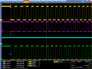

  • Hello Parth Parekh,
    You have mentioned that "But as soon as we plug in the 24V adapter the IC stops working and won't work with 12V adapter either" >> after power cycle is the device working again?
    Also, can you share the waveforms of VIN,PG,VCC & SW for both 12V and 24V adapters also the Zoom portion of VIN raising at starting.
    How many devices you have tested and how many are showing this issue?
    Haseen.

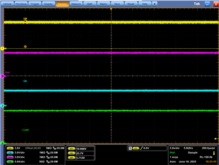

  • Hi Haseen,
    here is the link of DSO testing which include below testing parameters:
    https://drive.google.com/drive/folders/1ojFvlorHyYkdrmNttPktm_d10fjXnySo?usp=sharing
    1. we tested with 12V 0.5A adaptor : working perfectly with and without diode protection
    2. we tested with 12V 3A adaptor : working perfectly with and without diode protection
    3. we tested with 12V 10A adaptor : not sustained without diode protection (not tested with diode protection)
    3. we tested with 24V 2A adaptor : working perfectly with diode but not sustained when removed diode.
    4. we tested with 19.5V 2A adaptor : working perfectly with and without diode protection
    we have blown away 6 or 7 buck converter ICs, all have different fault
    one have showing short between output and gnd
    one have showing short between input and gnd
    one showing short at both end
    one showing short between feedback pin and gnd

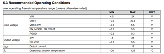

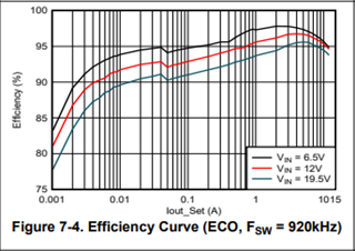

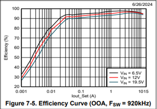

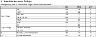

    we are not able to understand what is the main reason behind the issue, the datasheet showing it has absolute maximum input voltage capabilities up to 28V and typically 24V.
    we also found out that there is not single graph shown in datasheet which has used input supply of 24V, there is only 3 input supply tested and showed with graph 5.5V, 12V and 19.5V.
    is that mean this IC is not capable to handle 24V as input ?
    our testing conclusion also found whenever input supply voltage touch to 24V or more it blown away and short internally, all components in the circuitry working perfectly accept buck converter.
    Dhruvit

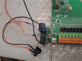

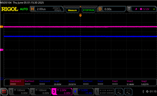

  • Hi Haseen,
    I have mailed all drive files.
    we are measuring voltage before VIN capacitor,
    our power supply is giving 24.1V or 24.2V voltage sometimes, to encounter this we have placed junction diode at input supply so that 0.7V drop make it to 23.5V to 23.6V so the upper maximum 24V limit can be secured.
    we thought these can be issue but our one of device just blown out which is running on 12V 0.5A since last 2 days, few minutes ago when we disconnect the supply and again connected it didn't start, we check it with DMM, and output is same VOUT shorted with GND.
    we are thinking about total wattage it take compare to its output, based on that if output at 5.15V 12A then total output power is 61W, if we divide this with 24V and 12V then 12V 5A and 24V 2.5A can be maximum input supply.
    Video's are compiling in mail.

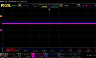

    here blue is input and Pink is output.
  • Hi please review this 2 video
    in with diode configuration buck working perfectly
    when we do same without diode its suddenly blown away.

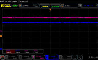

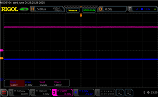

  • Here is one more instance
    in 1st image as you can see we have used 24V supply with diode in between so average 23.3 something is going in to Buck converter, in pink side as you can see 5.1V average is coming out of Buck converter.
    in 2nd image, now we have turned off the buck and again turned on, this time it showing unwanted behavior for same input supply it is giving output of 2.3V to 2.5V.
    when i checked enable pin, its 0V which means something happening with this buck with 24V supply.

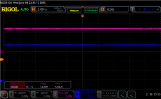

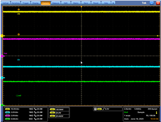

  • Hi Dhruvit Bhimani,
    From the video i see that you are measuring input voltage using multimeter and it will show average value(we miss instantaneous value).
    However we would like you to capture input voltage right at the buck input pin VIN pin1 in oscilloscope set trigger on VIN at 15V set 50ms/div and it will capture starting voltage and we can see spike is within the limit or not.
    Capture above waveforms with and without diode.
    Once you capture above waveforms as an experiment connect 200uF electrolytic at VIN pin and see the input voltage at starting.
    Haseen.
  • Hi Haseen,
    We have tested the setup based on your given instructions at the VIN pin of the buck converter.
    We used a 270µF, 35V electrolytic capacitor along with a 24V power supply.
    Images of both setups have also been shared.
    now used with 270uF 35V electrolytic capacitor at input side.
    I hope this all testing worth solution.
    Dhruvit

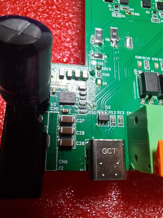

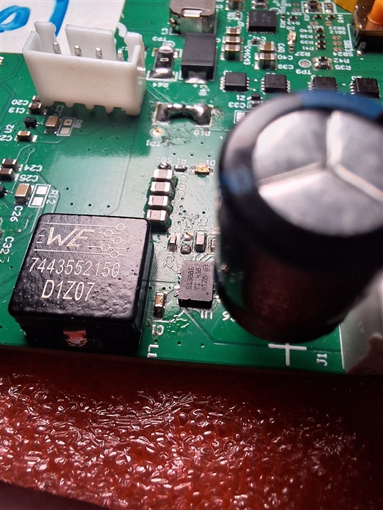

  • Hi Haseen,
    We have tested the buck converter without the junction diode protection at VIN, and it's working thanks to the electrolytic capacitor.
    I also found something interesting:
    All the buck converters that were previously damaged were purchased from Digi-Key but assembled in China through JLCPCB (supplier: LCSC).
    After adding an electrolytic capacitor at VIN, the buck converter that failed was the one assembled by JLCPCB.
    On the other hand, the buck converter that was both purchased and assembled through Digi-Key is working fine.
    Key observations from testing:
    1. This buck converter requires an electrolytic capacitor at the VIN input for any supply voltage over 5V.
    2. The buck converters assembled by JLCPCB may be faulty or possibly not genuine.
    I will share the overnight testing results on Monday to confirm whether they survived or not.
    Attached are two images of the buck converter ICs—one from JLCPCB and one from Digi-Key.
    Could you please help verify if the JLCPCB buck converter is genuine?
    Dhruvit
    Buck assembled in JLCPCB : ALL5 G3
    Buck imported from digikey : AT28 G3

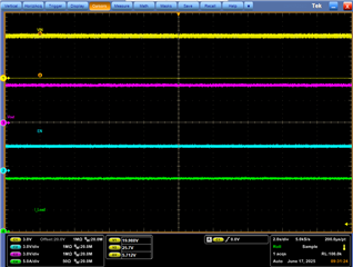

  • Hello Haseen,
    After extensive testing, we observed that adding a 270µF capacitor to the input side did not provide a consistent solution. While this modification allowed a few units to operate correctly, the majority of devices still fail to function as expected.
    We tested multiple ICs and confirmed that the voltage on the EN pin is above 1.1V, and the ESD protection on all buck converter pins is intact. Despite this, several units do not provide any output, with no clear indication of the root cause.
    All devices under test are identical in design and component selection, so the inconsistent behavior remains puzzling. We would appreciate your guidance in identifying any potential issues that could lead to such variability in performance.
    This is the number of IC which are having all the ESD rating perfect but isn't just working. Is it possible that the ICs have entered a fault mode? If so, what are the possible causes, and how can we recover them from this state?

    Input voltage details:
    • Solar panel: 20W
      • Open circuit voltage: ~22V
      • Loaded voltage: ~19.8V
      • Both are within the 24V recommended and below the 28V absolute maximum.

  • Hi Dhruvit,
    I got a chance to check on EVM(TPS51388EVM - same as TPS513885 and only major difference is Variable output voltage -TPS51388 Vs Fixed output Voltage-TPS513885).
    EVM is configured for 5V output and testing EVM at24V input 12A output (worst case).
    Multiple VIN ON and OFF Cycles perfectly working fine:
    Continuous testing in progress
    By Evening will share another waveform.
    Haseen.
  • Hi Dhruvit,
    Below is the waveform for 24V input ran for 5 hours continuously.
    Now i have increased the VIN to 25.5V and let it run overnight and will share the waveform tomorrow.
    Haseen.
  • Hi Dhruvit,
    Below is the waveform for 17 hours of testing and its absolutely working fine and infact i have increased the VIN to 25.5V
    Haseen.
  • Hi Haseen,
    Thanks for testing and sharing your results.
    Along with your testing using the bench power supply, we also replaced the buck converter on the EVM board and tested it on our solar setup, which is similar to the field conditions. This new setup is working fine.
    This supports your earlier observation that transient voltage from the 24V power supply might be the cause of the issue—something that doesn’t happen with bench or solar power. That’s likely why the EVM works fine on your bench supply and our modified setup also works fine on solar.
    However, we are still unsure why the earlier two solar-powered devices failed, while the current EVM with a new buck is working properly.
    Is it possible this could be a problem with a specific manufacturing lot?
    All the buck converters we purchased from China (via JLCPCB) and assembled on PCBs are non-functional—not a single one is working. A few from Digi-Key have also failed, though some are working.
    Looking forward to your thoughts on this.
    Dhruvit
  • Hi Dhruvit,
    These would be duplicate parts hence please purchase parts from ti.com.
    Haseen.
