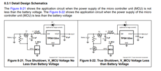

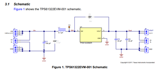

Hello TI experts!
I am trying to select a switching Regulator for my company's design where PCB is very small. I have evaluated many regulators, and read many articles on Internet. All regulators have an input capacitor C1. This includes many TI regulators. But the TPS61322 does not have C1. No explanation is given in the datasheet. I am tempted to use this regulator, but reluctant due to lack of explanation. Can TI experts explain this please. Thanks.
