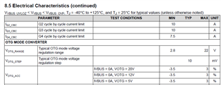

We are currently evaluating BQ25792.
In the datasheet, when the ambient temperature (TJ) is 25℃, VOTG_ACC is specified as +3% and -3.5%.
Do you have any characteristics for this VOTG_ACC when the ambient temperature (Tj) changes?
We would like to know the accuracy of VOTG_ACC at -20℃, 0℃, and 50℃.
Masashi
  • Hi Masashi,
    The -3.5%/3% are over -40C to 125C range.  I do not have -20 or 50C data.  From 0 to 85C, the accuracy improves to -2% to 2.5%.  As per the datasheet curve below, the accuracy shifts more negative as the VOTG setting lowers.
    Jeff
  • Hello Jeff,
    I understood that it is +3% to -3.5% over all temperatures and +2% to -2.5% from 0°C to 85°C.
    I also understood that the accuracy changes depending on the VOTG voltage.
    Masashi
