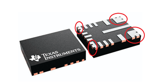

Part says its 16 pins, mechanical information says 22. So which is it?
  • Hi Mark,
    It looks like some of the pins are "shorted" together on the package.I think this is where the discrepancy is coming from. I think there are other ti devices that share this package where each of the shorted pins represents a 22pins.
    Yes, the device should only have 16 pins. see below. I circled the shorted pins.

  • No, there is a 16 pad VQFN and a 22 pad VQFN. If pads are shorted together, the pads would be called out differently. There are even unshorted pads for example, pad 17. So thats not it. I know what it is but I cannot proceed until the problem is fixed and I have a new data sheet.
    See my attachment of a different part that actually calls out a 16 pin vqfn and its package outline. Its shown below. The problem with the data sheet for the 61495 is its lumped together with other parts. IF the part is indeed a 16 pin VQFN and follows the pinout the package outline is completely incorrect for a 61495, the part is 16 pins and the package outline in the data sheet is 22 pads and it has nothing to do with pads shorted together because the package outline in that data sheet does NOT show land patterns for shorted pads it shows land patterns for individual pins PLUS the pinout does NOT mention pins 17 through 22 as no connects or anything else.
    As shown below, which is what I believe the package outline should be, there are 16 pins and 16 pads and yes the corner pads are rectangles to take into account shorted connections on the physical device.
    Even if I could use the physical package outline from this other device it does not necessarily correctly correlate the pinout of the 61495 to the package outline.
     The 61495 data sheet does not either:
    A. Have the correct pinout on pages 4 and 5 or
    B. Have the correct package outline shown on page 61.
  • Hi Mark,
    I don't understand what the issue is. Everything in the DS is correct. The pinnout on page 4, 5, and 61 all have 16 pins. the only thing that doesn't have 16 pins is the RNL0022A document which is not related to the lm61495 part. I don't know where you found that document.
    Everything in the DS points to the LM61495 having 16 pins. Including the documentation at the end of the DS.
    Andrew
  • Hi Mark,
    I looked at the -Q1 datasheet I see what you mean. The LM61495 (non-Q1) has the right information at the end of the DS.
    Can you use that one?
    https://www.ti.com/lit/ds/symlink/lm61495.pdf
    I'll see what I can do to revise the DS, but it may take some time.
