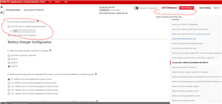

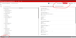

Hello why this buttons is not active ?
I use the TPS26750EVM board plugin and GUI Composer Runtime was installed
  • HI Dmytro,
    If you try to use the "Export" option, are the options also greyed out?

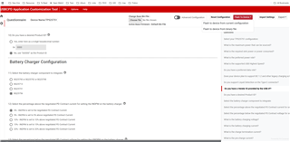

    If yes, then the buttons are likely disabled because you have not completed the GUI questionnaire.
    Please go to the second page and ensure all questions have been answered.
    As an example, I left q10 unpopulated, and the flashing option is greyed out.
    Once I answer it, it becomes a valid option.
