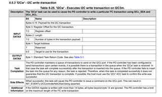

Hi there,
I am using a TPS25751 (has an eeprom) with a BQ25798. I have my system connected to the PMID pins and from there on it goes threw a TPS552892 where it takes it to 5V.
When I use the online web config my system powers up when usb c is plugged in but when I unplug it my PMID voltage is 0 when I unplug the usb c but the battery voltage is 4.1vs.
I am using a 1s Battery. I read in the data sheet that I need turn a register on. However, I cant seem to find how to do that in the web config. Do I need create a custom patch file?
