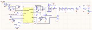

Using both WEBENCH and the spreadsheet SNVR481 we came up with the design below:
/resized-image/__size/320x240/__key/communityserver-discussions-components-files/196/pastedimage1748913144995v2.png
Please note that the value for R86 is wrong. It should be 3.3k instead of 33k. Also, R75 is unmounted.

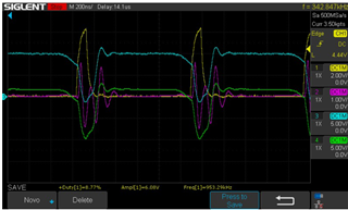

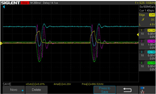

We captured some pictures to try to figure out the issue.
Yellow: Gate Voltage
Purple: Source Voltage
Blue: Drain Voltage
Green: Diode Anode
0A Load:
2A load:
I'm really confused. Since these images were captured with 24V on the input and on the output, I was expecting to see around 50% duty cycle. What could be the cause for this low duty cycle? I checked and the on time is close to the minimal on this switching frequency.
Also, the gate curve does not look good. It looks quite slow. Can it be the reason for the MOSFET dissipating too much power?
  • SEPIC schematic.pdf
    I don't know why, but the schematic photo was uploaded with very low quality. Here's the same image on a PDF

    The spreadsheet and the pictures you requested are attached. It turns out that the previous pictures were not captured correctly. On the new pictures we can see a duty cycle closer to 50% under load conditions. I'm sorry for that. Although, we still have the overheating problem with the MOSFET.
    On the pictures with multiple signals:
    Green = Vout;
    Blue = Vin.
    Yellow = MOSFET gate;
    Purple = IC CS pin.
    On the picture with only one signal, the signal is the switching node.
    5810.SEPIC.zip

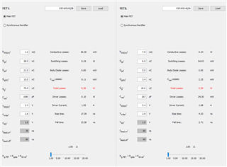

    Regarding the losses in the FET, please use the power stage designer to see how the losses are distributed in different conditions https://www.ti.com/tool/POWERSTAGE-DESIGNER   - First select the topology you use and insert the circuit specs, then choose- FET losses calculator- on the left side:
    You can also easily compare both FETs.
