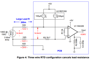

    Could you please provide a schematic of the customer's design to help me better understand what their system looks like?
    Is the customer implementation similar to this schematic below but with different lead resistance values where it is labeled as 1mV (10Ohm) here? If not, could you please help clarify where the 0.9Ohm difference is being measured?
    In general, a voltage difference between the two inputs to the op-amp (in this example, the INA326) will cause a different Vout value, and this can be calibrated via software.
    Please find a design guide for a 3-wire RTD here: https://www.ti.com/lit/ug/tidu969/tidu969.pdf

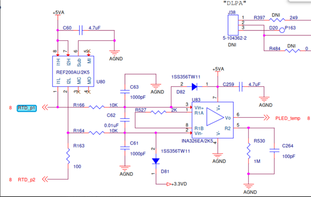

    You may refer below of our schematic for your reference.
    FYI, we measured 0.9 Ohm from pin 2 and 3
    Best Regards
    Hatzrill
  • Hi Hatzrill,
    Thanks for the update!
    It is true that the 0.9Ohm difference may cause an offset in the measured output voltage, but this impact should be small. Additionally, system software can be adjusted to take this into account.

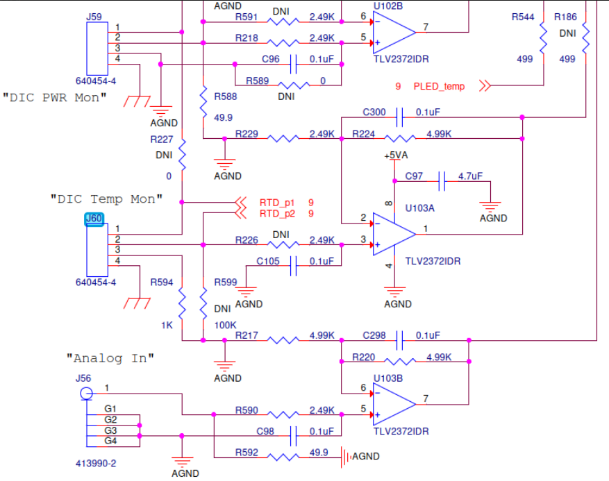

    Based on our customer's feedback, the damage at U80 does not related to the resistance max and min temperature because as referring to schematic diagram, RTD sensor is not connected at J60 at customer tools.
    Hatzrill

    The failure for the REF200AU/2K5 part is an observed 0.9 Ohm resistance between pins 2 and 3. RTD sensor is not connected at J60 when power up at tool and U80 is damaged.
    Please refer below for the schematic diagram for the J60 locations.
    Hatzrill

    I do not understand the significance of REF200 having a resistance between pins 2 and 3 since pin 3 of REF200 is unconnected. Is this what you mean?
    Are you seeing changes in the current being sourced in the REF200 after it is damaged? Additionally, can you please describe, provide photos, or provide scope captures to show how REF200 was damaged?

  • Hello Jackson,
    We load the resistance between pins 1 and 2, not pins 2 and 3 (pins 2 and 3 are GND).
    Referring to end's customer reply:
    Measurement pin 2 and 3 is shorted and near 0 Ohm, but from Plexus test engineer's measurement, there is a 0.9 Ohm.
    Hatzrill

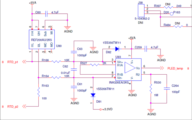

  • Hello Hatzrill,
    It seems like measurement pin 2 and 3 are different from pin 2 and 3 on the REF200. However, I do not see measurement pin 2 and 3 on the schematics you have provided. I see "RTD_p1" and "RTD_p2", which I could maybe assume are pin 1 and pin 2 of the measurement pins, but you have not mentioned pin 1 being a problem, so I assume that isn't what we need to look at here. Additionally, you have not provided any more information regarding what sort of damage you are seeing on the REF200.
    If you would like more assistance, please provide a clearly labeled schematic or block diagram as is shown above with the 0.9Ω measurement clearly labeled alongside measurement pins 1, 2, and 3.
    For further support, could you please provide some characteristics about the customer's RTD? What is the resistance measured at min/max temp, and could you please provide the missing schematic section following nets RTD_p1 and RTD_p2?
    Can you also provide a response to what Andrew has asked for above? Why can the 0.9Ω not be accounted for in system software and can you please provide more details about the customer's RTD, including missing schematic sections?
    In summary, for further assistance, please provide all of the following items:
    1. A schematic or block diagram with the 0.9Ω measurement, REF200, and measurement pins 1, 2, and 3 clearly labeled.
    2. A detailed description, photos, or scope captures that outline the damage and/or change of behavior of REF200 that you mentioned previously.
    Jackson

    The RTD sensor wasn't connected into the J60 connector when the tool was turned on, and the U80 is damaged. The statement also suggests that since there's no load attached, the damage to U80 wasn't caused by the resistance, or the maximum and minimum temperature readings.
    Also, here is the missing schematic for section following nets RTD_p1 and RTD_p2:
    Hatzrill
  • Hi Hatzrill,
    I am still not sure what you mean when you say there is damage to U80. My previous understanding is that there was a 0.9Ohm resistance measured between pins 2-3 of U80, but this is not relevant as pin 3 of U80 is NC. Could you please provide more information about how the IC is failing?
    If you are measuring 0.9Ohms difference between the rails going into pins 2&3 of the comparator (U83) this can be accounted for in software as stated before.
    For further support, please clearly define what damage you are seeing and where it is found. Also, please clearly define the system setup for your tests.
