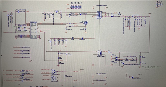

  • I have already replaced the 749022016 transformer, and the 10G Base network has been successfully verified to work—but only without the PD circuitry connected. Previously, when we added our own PD circuitry, communication errors consistently occurred. Therefore, we are looking for a ready-to-use PD circuit design that has proven experience working reliably with a 10G Base network.
  • Hi Jacky,

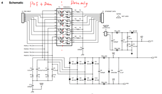

    Can you share the schematic and the data transformer datasheet? It may be the pins connection issue. One common miss is the CM choke of the data transformer is usually on the data only side, rather than the PoE + data side.

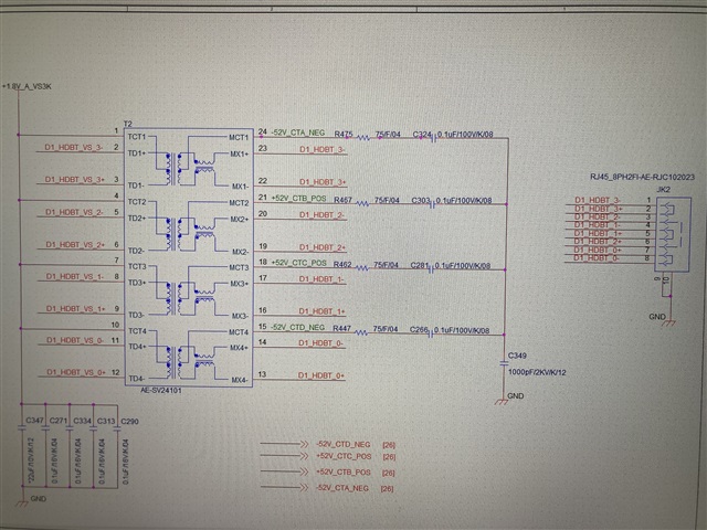

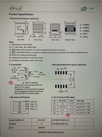

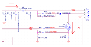

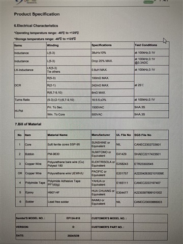

  • The transformer specifications and circuit are as follows
  • Hi Jacky,
    Thanks for the documents.
    The transformer you shared is the flyback transformer. The data rate is related to the data transformer which is near the RJ45 port like below. Could you share that one?
    Diang
  • The datasheet and circuit of the data transformer are as follows.
    Datasheet : www.appselectronics.com/.../download.php
  • Hi Jacky,
    It could be the issue I mentioned. Please check the side of PoE+Data and Data only could be revised
    Diang
  • The left side of the transformer is the PHY, and the right side is the RJ45. Since the PoE power always comes from the RJ45 side, the PD must be connected on the right side. If it's connected on the left side, the DC power from PoE would be isolated by the transformer, so there's no way for any power to be delivered.

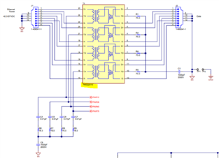

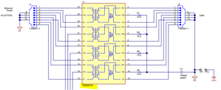

    In most of cases (90% or higher), the data transformer on PoE side is without CM choke as below diagram of TPS23751EVM-104 EVM. I would recommend you to double check with your data transformer vendor. If it is wrong, you may consider reversing the data transformer to make your CM impedance of data side or maybe data speed won't be influenced.
    Diang
  • We previously tried reversing the transformer, but it didn’t help.

    Thanks for your information. If the data transformer does not cause the issue, you can check the layout of the RJ45 termination and PD input circuits. Check list is shown below.
    Besides, have you saw the data issue is related to the power load? Will the behavior the same with 0% and 100% load?
