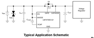

According to the Typical Application Schematic, the NchFETs are connected in reverse order of normal.
This prevents reverse current, but I believe the current from Vin will go out to Vout at switch-off.
Is this the expected behavior?
