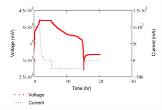

    Yes, you need to include both the charging and discharging phases in the log. Please follow the steps in the documentation provided. Your data should resemble the graph below.
    Diego

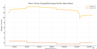

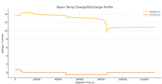

    Here is a graph of the data:
    Was there an error message in the email the report was sent in?
    After fully charging the cells, the cells are not fully relaxed when the discharge phase begins, the voltage is still fluctuating.
    I recommend including the full charging phase in the log file.
    Diego
  • There was not an error message in the email.
    This process takes a very long time so it's difficult to allocate the necessary time to perform a cycle and put an entire discharge in front of that, but I will try when I get it in a functional state. This is now blocked by the problem in the other thread that keeps me from charging the battery all the way because FC is falsely set.
    You can change when the FC bit is set by changing FC set % to -1. The FC bit will then set when valid charge conditions are met.

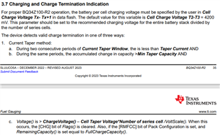

  • Hmm, what would valid charge conditions be in this circumstance? Can I still perform a learning cycle or a gpcchem data collection with FC set % at -1?
  • Also, I am starting with a chemid of 460. I have also looked at 461 and 402 but figured 460 is the closest to my battery. What do you think?
    It is a 4S LiFePO4
  • Oh, and after I program 460, it still says LION in Device Chemistry. Is this correct? Is there a place to see the actual programmed ID or would I have to pull out the individual values to make sure they are programmed?
  • Hi Matthew,
    charge termination conditions can be found section 3.7 in the TRM.
    Yes, this is the preferred method.
    It is a 4S LiFePO4
    Please use the GPCchem tool to identify the best chemid, we recommend unsing a chemid with 3% dod % error or less.
    You can check the chemid by sending the chem_ID cmd 0x0008 or checking the value in dataflash.

  • OK I just spent a whole 2 more days trying to perform the learning cycle again and got another zero. PLEASE tell me what I could possibly be doing wrong. Here is the data I uploaded:
    5164.roomtemp_rel_dis_rel.csv
    ProcessingType = 2
    NumCellSeries = 4
    ElapsedTimeColumn=0
    VoltageColumn = 1
    CurrentColumn = 2
    TemperatureColumn = 4
  • Hi Matthew,
    We are not completing a learning cycle, that is a completely separate process. We are generating data to use for the GPCCHEM tool to get a chemid match.
    Data looks ok, what error message was in the email?
