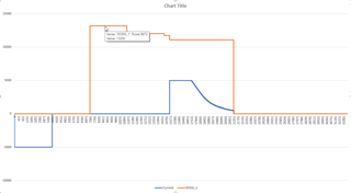

We encounter a learning cycle issue. When conducting the learning cycle with the cell Chemistry ID we applied for ourselves, it has never been successful. When we use the same testing method and change the Chemistry ID to test from the Chemistry ID library, it succeeds. The attachment is two log files from the testing process. Please help analyze what caused it.
Note:
ID7963 : This is the ID we applied for after providing the cell. The learning cycle cannot be completed with this ID.
ID7236 : This is the Chemistry ID returned from the Chemistry ID library after we uploaded the gg file. This ID can successfully complete the learning cycle.

    Thank you for confirming, I believe the issue here is coming from the DOD0 measurement taken after the discharge to empty. For the gauge to complete the initial Qmax update, the distance of the DOD0 measurements taken before and after the charge period must be at least 90% of the total range. In the case of the 7963 ID, you can see that at its highest, the DOD0 measurement after the discharge to empty and before the charge is 13200, and after the charge it is 0.
    The total range of DOD0 is from 0 to 16384, so taking this into account:
    (13200-0)/16384 = 0.80566 -> 80.566%
    I believe in this case, the cell will need to be more deeply discharged during the discharge to empty phase of the cycle to increase the DOD0 measurement at this point. If you look into the log for the 7236 ID, it meets the 90% condition at this point.
    Anthony

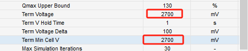

    Thanks for your help! It still failed after retesting. The UVP voltage we set is 2.7V. When discharging to this voltage, the battery has basically lost its capacity. The fail log of the re-test is attached. Please help analyze the possible causes of this problem again. Thank you!20250610 Log.rar
  • Hi Rain, Jeff,
    Looking into the difference between the two chemIDs, I believe I see where the issue is here. During the relax point after the initial discharge, the voltage rebounds pretty sharply back up to to ~3200mV, where in the OCV table for chemID #7236, this is still near the end of the OCV table, classifying it has a higher DOD point. However, in the chemID #7963 OCV Table, 3200mV is much earlier in the table, making the DOD much less at this point. Since this is occurring during the discharge to empty step, the discharge rate doesn't matter as much as the second discharge since resistance updates are not occurring (which requires at least a C/10 rate, preferably a C/5 rate).
    Based on this information, I would like to try reducing the discharge rate in this first step to try and combat the voltage rebound at the end of the discharge, which I believe could give us a higher DOD point when the cell is relaxed. Can you please try this test with a 1.5A or 2A discharge during this discharge to empty step? We do not have to repeat the entire test; once the discharge has completed and the cell has relaxed, we can check the DOD0_1 value to see if the rest of the test is going to be successful.
