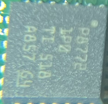

Hi team,
Please help to check the top marking LP87725105RAGRQ1.
Leo

Hi Leo,
In order to know about the LP87725105RAGRQ1, Please check the internal register bit "TI_NVM_ID". This bit should be 05 indicating the correct part number.
I don't know if that is something that you wanted to know by checking top marking.

It could be so that it is pre-production sample. Usually in pre-production samples, we can burn settings of the new NVMs in order to support customers in their initial build.
Can you let me know which orderable part number against did you get this ? If the OPN is not yet released then it make sense why you would have different marking.

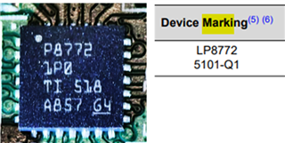

In the highlighted DS marking, it is of LP87725101RAGRQ1 which now released device. So if you have ordered that device and you have different marking then let me know?
Ishtiaque
After a little more digging yes, it looks like the marking you showed in the photograph is correct for the pre-production unit P87725105RAGRQ1.
