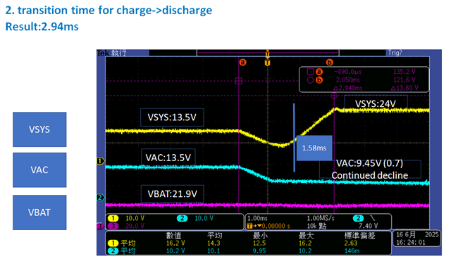

auto reverse mode will still function within 50us, from charge mode to discharge mode?
Hello Marco,
Yes, that is correct. Auto reverse mode will trigger in ≈50µs once VAC falls below the ACUV voltage.

Hello Marco,
50µs is the time for reverse mode to start operating. The time for the system voltage to rise up to VSYS_REV will depend on a wide variety of factors.
How can I confirm the conversion time of 50us?
I'm not sure what you mean by this question. I measured the response time of 50µs by measuring the time between the charger switch nodes turning-off from VAC falling to ACUV and the switch-nodes switching again when reverse mode was activated.
Let me know if this answers your question.
Ethan Galloway
Hello Marco,
Here's an app note that shows the results of auto reverse mode: https://www.ti.com/lit/an/sluab05/sluab05.pdf
I measure the time for the switch node (SW2) to stop switching (powering forward mode) to start switching again (powering reverse mode).
