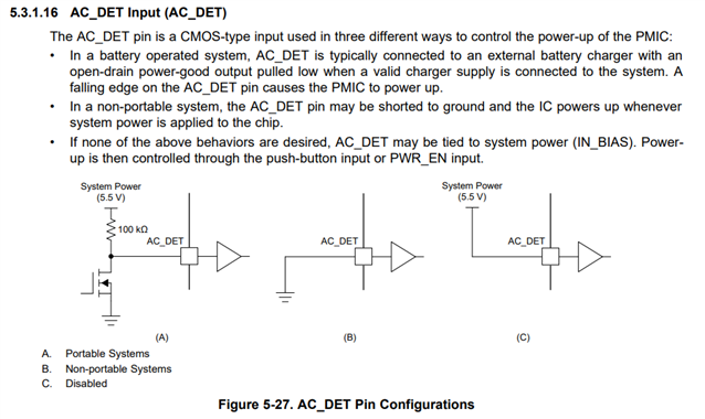

Our platform uses PMIC TPS65218 and we have several units experiencing its abnormal behavior.
I describe the situation we encountered as follows.
  1. Pulling AC_DET to GND should be used to trigger the power on sequence, but these units cannot. They are normal to use the PB pin to bootup.
  2. When the system is operating normally, pulling AC_DET to GND will cause the system to shut down and PGOOD will also show the low voltage of logic 0.
  3. When PGOOD is at low voltage described in item 2, the voltages of DCDC1-4 and LDO1 are all normal.
  4. In addition, when the input power is normal and there is no trigger source, AC_DET itself will toggle continuously.
Have TI member ever encountered a similar situation or know what might cause this?

    Can you clarify how AC_DET is connected in your schematic? Is it like A, B, or C, or something else:
    Is EN asserted high after AC_DET is being pulled low? Is EN pulled low at any moment?

    Our application is type A.
    The behavior of the EN is a bit complicated, so I will describe it separately.
    (1) After booting by PB, EN is asserted high. At this time, AC_DET is pulled low, EN keeps high and PGOOD goes low. System shut down.
    (2) Pull AC_DET down to low to start up. The EN voltage is sometimes high and sometimes low, but the system cannot be started.
    Later I found that AC_DET and PGOOD are short-circuited, and I am sure it is not a manufacturing problem. What are the possible causes of this?
    Or there is sudden voltage input into which PIN will cause such a problem.
