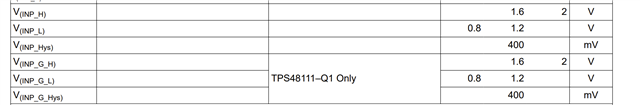

    This would theoretically work- but the timings and capacitances might be a bit tricky. The logic level high for this device has a maximum of 2V. You essentially have to size the capacitor so that the INP_G pin does not start charging until the INP pin hits 2V.... which might make startup a bit unpredictable with timing.
    Tim
  • Dear Logan,
    did you mean if the individual TPS48111-Q1 chip has 1.6V V_INP_H, 2V V_INPG_H,
    we need to take this worst case into account, is my understanding correct?
    by the way, May I know the typical impedance of INP and INPG pins?
