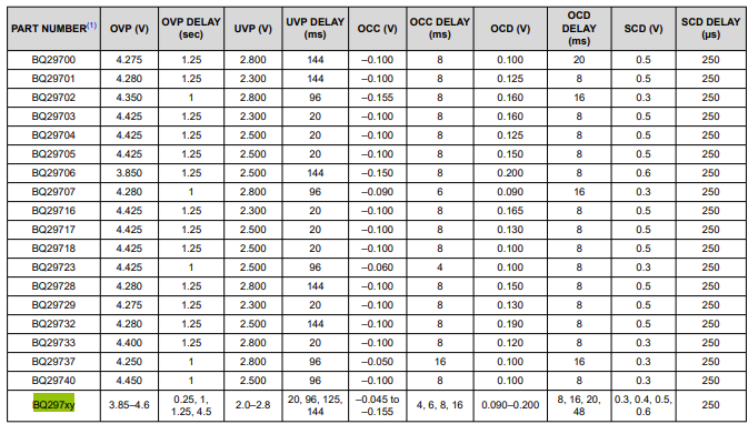

Hi expert,
My customer (CosMX) is looking for a 2nd protector device which OVP is 4.55V and OVP delay between 4-9s. Do we have suitable devices?

  • Hello Ryker,
    For 1S protectors we have:
    • BQ297xy family (max delay is 4.5s for OVP)
    • BQ298xx family (max delay is 4.5s for OVP)
    • BQ2946xx family (max delay is 6.5s for OVP)
    I would double-check the specifics to make sure they are what you are looking for.
    For all of our 2S protectors, they should all meet the OVP requirement and most will have the max delay option of 6.5s. I would recommend going to TI's Battery Protectors page to help narrow down which one would be better for what you need.

  • Hi Alexis,
    What's the full part number of BQ287xx, BQ298xx, BQ2946xx. I can't find suitable full part number that can meet the 4.5s/ 6.5s delay time.
    Ryker
  • Hello Ryker,
    BQ297xy, etc. is a placeholder row to show the available settings that TI can program. It is not an actual orderable part yet. Requesting a new version with the requirements you would like requires a significant business case to warrant the development. Is this something they would be interested in?
