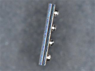

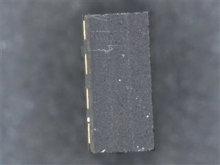

  • Dear Alan
     I have a mistake.
     It was mercury lamp, not halogen light.
     When our PCB board with BQ27Z561-R2 mounted was turned on about 5cm from the mercury lamp, BQ27Z561-R2 does not start.
     As we gradually moved it away from there, BQ27Z561-R2 started when it was about 25cm away from the mercury lamp.
     When BQ27Z561-R2 is working, if we move it back to about 5cm from the mercury lamp, BQ27Z561-R2 still works.
     If we attached the black label to the BQ27Z561-R2 and our PCB board was turned on about 5cm from the mercury lamp, BQ27Z561-R2 start.
     "molded" mean resin mold.
     Please refer to bellow two pictures.
     One is BQ27Z561-R2 side picture.
     Another is other device's side picture.
     Could you do resin molding on BQ27Z561-R2?
                              (a) BQ27Z561-R2 side
                              (b) Other device side
