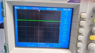

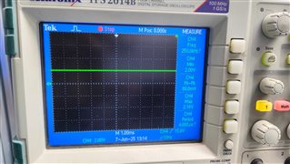

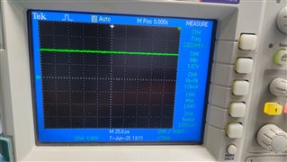

I am using this IC for buck converter PS where input is 16V to 50V and output is 12V/500mA.
At the time of on load voltage drops to 8 volts. What can we do.

please find waveforms at , Input voltage is 26V
1. NO load
2. .05A load
3. .055A load
4. .06A load
1. No load
Without load SW
Without load Vout

2. .05A load
50mA Load Vout
50mA Load BST-SW
50mA Load SW
50mA Load Comp
3. .055A load
55mA Load Vout
55mA Load SW
55mA load Comp
55mA Load BST-SW
4. .06A load = Vout going 0Volt
60mA load BST-SW output-0V.
60mA load Comp output-0V.
Hello Engindi
Could please check with placing an electrolytic capacitor of 100 uF at the input for damping? See if it helps. Additionally, reduce inductor value to around 100 uH, currently it is quite high, it will reduce effectiveness of current control.
Let me know if this helps
