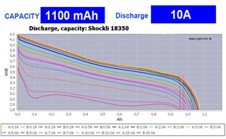

I'm attempting to use a BQ27427 with a Shockli (Funkowa) 18350 battery.  It claims 1100 mAh capacity, a max continuous discharge of 10 A, and 3.7 volts.  The discharge curves they provide show a starting voltage of 4.2 volts and a final voltage of 2.8 volts..
