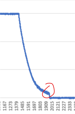

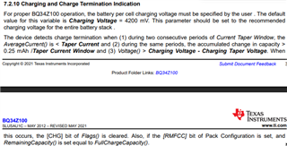

My problem is that the gauge seems to intermittently be setting FC prematurely so I can't actually charge it past around 13344 mV.
This is my first time working with a battery in this manner, so I fully accept that this is likely going to be due to user error. Can you help me spot some misconfiguration or give me some leads on why this may be happening? Any advice on anything else I screwed up is welcome.
Thanks!
  • I have lots of questions around the values for certain things and how they relate to this battery pack. For instance, should I make Qmax cell 0 5000 because that is the capacity for the entire pack? Then what about Cell Terminate Voltage? I set that to 2500 because it's the actual terminate voltage I want for the whole pack divided by the number of cells. Some of this was assumed by the max for those values. I've had a tough time finding values for my specific use case.
    For instance:
    Here it references the "Charging Voltage", but there is no variable to input the charging voltage.
  • Hi Matthew,
    Did you get a chemid match using the gpcchem tool?
    Did you complete a learning cycle?
    Charging Voltage refers to these parameters.
    Diego

  • Hi Matthew,
    Recommended charging conditions are specified in your battery datasheet. The values in TRM are the default values these values will need to be changed to match your charging scheme.
    Diego

    The problem I have currently is this:
    The SOC goes from about 94 directly to 0.
  • I just discharged it again with the default 460 chemistry (for which the Ra tables are very different from the learned one above) and it went from 96 SOC directoy to 0. It looked normal between 99-96. Before I did the learning entirely the SOC seemed to decrease at a normal rate, but it would get to 0 earlier than I expected. It was a very linear dropoff though.
    Then your ra tables updated from the learning cycle you previously completed.
    The SOC drop with the learned parameters is most likely due to a misconfiguration within the gauge. Please share a log and .gg file of the error you described.
    Diego
  • I suspect you are correct because now it appears to actually work while charging up. It even seems accurate! However, during the discharge the SOC drops to 0 prematurely as before. What could be causing that? Here are the files:
    5074.test2.log
    This is the log of me charging, discharging, then starting charging again immediately after the latest learning cycle was completed. You can see while charging it works fine, then during discharge the SOC drops to 0 prematurely.
    datamemory4.gg.csv
    For completeness I took the datamemory before and after this log. The above is before. Below is after:
    datamemory5.gg.csv
    The reason for the SOC crash is because of an incorrect FCC recalculation. Please allow mw sometime to review the data. In the meantime can you confirm all critical parameters are set correctly. Critical parameters can be found at the beginning of this document.
