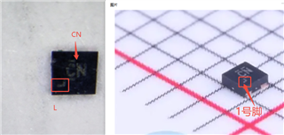

We use the LP5907SNX-3.3/NOPB in our board, and now, we need to know how to read the PIN#1 like below picture:
Hello Zhang,

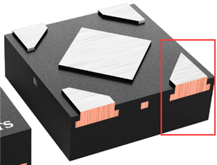

The top-side marking for pin 1 should be an "L" shaped character.
I found a photograph online of this exact component which clearly shows this L shape character, in the corner.
This is the "Pin 1 index area" as described in the datasheet on page 44.
