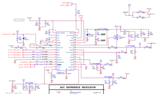

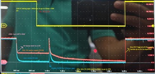

TPS65381A-Q1: During Sleep to wake-up event VSOUT1 supply latching to 2.5V, instead of 0V and not recovering on wake-up event other than power reset.
Part Number: TPS65381A-Q1
The step following to go to sleep as follow:
----- Turning OFF VDD5 (To make sure CAN sleep) > Going to STBY mode by writing 7D (WR_CAN_STBY)
A) Wake up sequence
Power on Reset:
- Enabling ALL supply by sending PM_CMD_EN_ALL command (0x7B15u) > PM_EnableVDD_SEN_5V()
IGN or CAN Wakeup:
PM_EnableVDD5() >PM_EnableVDD_SEN_5V()
PROBLEM Statement - VSOUT1 supply latching to 2.5V, instead of 0V and not recovering on wake-up event other than power reset
Please suggest appropriate solution:
 Circuit -
