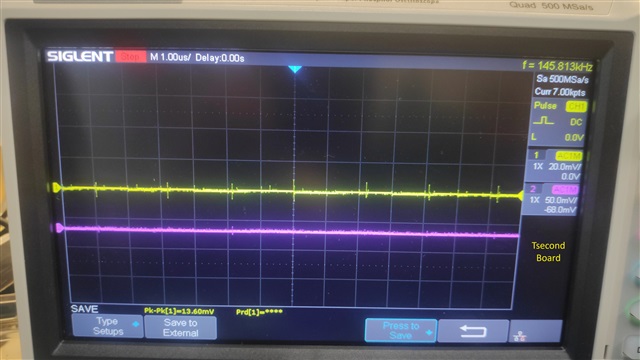

  • i'am Trying to upload to some initial oscilloscope plots, the TI support portal is not letting me do so.
    Can you help me on this.
    Mohan

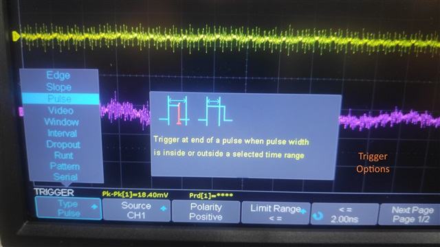

  • Tsecond Board Oscilloscope TraceTI EVAL Board TraceTrigger Options
    The First Image:- Tsecond Board. O/P node trace
    Second Image:- TI Eval Board O/P node trace
    Third Picture: - The trigger option available on my oscilloscope does not have the trigger to ripple option, Can you advice on this.
    Mohan
  • Was able to extract a more clearer plot / trace of the two output nodes ,
    There seems to be some switching happening at the output but not very prominent in terms of voltage swing
  • Thanks for the waveforms,  the device is switching but differently.

    Use the edge trigger, positive.
    Lets focus on one channel, use dc coupling on probe check En1, Vout1 (AC) , VOUT1 (DC), VIN1 pins(33 to 35) to PGND (pins 24-26).
    probe near vout feedback connections and document where probes were placed during measurements.
    Capture start up of Vout1 using single shot trigger on Vout1 DC or normal mode DC coupling when powering up.
    Then capture Vout1 after operating in steady state.
    Capture VIN1 pins(33 to 35)
    Capture VIN2 pins(4 to 6)
    Capture BP5
