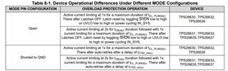

I have a question about the protection function of TPS26631.
1. Is it correct to understand that the latch-off/auto-retry of the following protection functions can be switched with the MODE pin?
・OVP
・Active Current Limiting With 2 × IOL Pulse Current Support
・Short-Circuit Protection
・Start-Up With Short Circuit on Output
・Thermal Shutdown
2. If it is set to auto-retry, could you tell me the ton for each protection function?
