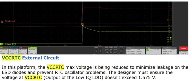

We are currently evaluating a replacement for the AP2138N-1.5TRG1 LDO due to an overshoot issue during startup. The overshoot currently observed is exceeding Intel Panther Lake's requirement (overshoot limit: 1.575V).

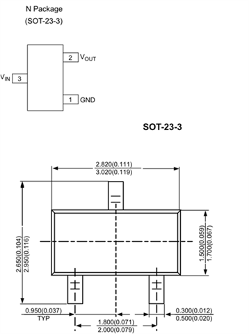

SOT-23-3 or similar small footprint package

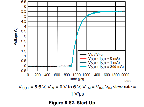

    Now this overshoot is not really a characteristic we have since our start-ups don't tend to over shoot, quick example from TPS7A20's datasheet start-up graph below:
    There are cases where an LDO can end up in drop-out very briefly as the input is ramping up. When the LDO exits drop-out it can at times overshoot, which seems that could have happened in the scope shot provided.
    Do you know what were the other conditions here? Cin, Cout, Iout? Is the Diode out at the input of the LDO?

    Package size: mm2 8.12 mm2: 2.8 x 2.9 (SOT-23|5) 8.12 mm2: 2.8 x 2.9 (SOT-23|5) 8.12 mm2: 2.8 x 2.9 (SOT-23|3)

    We are reviewing the power design with RD again for VCCRTC and would like to clarify the following:
    1. The typical VCCRTC voltage is 1.5V, with a ±5% tolerance, meaning it can go up to 1.575V.
    Is this considered within spec for normal operation?

  • Hi Scott,
    For both TPS7A2015PDBVR and TPS7A0315PDBVR the 1.5% tolerance takes into account line, load, and temp. So under normal operation this 5% spec should be fine. That being said, given that the max current is 2mA for the RTC, TPS7A0315PDBVR would be a good fit.
