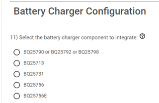

    These devices are not intended for source only applications so there will be some additional effort and cost to address.  Additionally, an MCU of some kind would be required to serve as an interface between the PD controller and BUCK regulator stepping down the 24V to the negotiated contract (5,9,15,20).  If you look at the current GUI configuration tool you will see the current BQ devices with which we have integrated the interface drivers into the PD controller.
    USBCPD Application Customization Tool

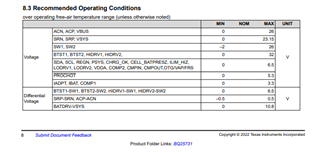

  • Hi Chris,
    I believe you were initially correct on the BQ25731 - the allowable input Vbus is 26V which will work with our 24VDC supply input.  Max Vsys of 23.15V is the supply for battery charging and to the TPS25751 if I am reading the datasheet correctly.

    The TPS25751 (and the TPS25750) automatically configure the BQ25731 based upon if the TPS25751 is in sink or source mode.  In the sink mode the TPS sends to the BQ via I2C the commands to disable OTG and enable charging.
    https://www.ti.com/lit/ds/symlink/bq25731.pdf#page=42  write 0x0E to regiter 0x00
    in source mode
    write 0x0F to register 0x00
    write 0x14 to register 0x35
    My concern is that you are using the BQ25731 in a direction that is opposite what the TPS25750/1 is expecting.  You would need to bypass the I2C events of the TPS25750/1 and use an MCU to control the BQ part based upon the negotiated contract.
