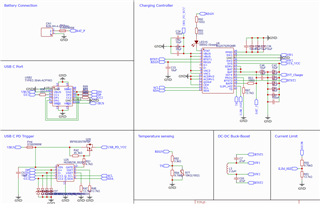

Charge Current wont Rise to the expected value of about 2.35A acording to the set Value via the ILIM Resistor and the I2C Register Values.

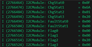

Charger is in Fast Charge Mode, supplied with 5V or 12V it only charges the Battery with a few Milliamps. Battery Connected is 3S LI Ion 12V.
Stat Pin is Low, CE is pulled to GND. No Ship Fet, no ACDRV Fet.
  • Hi Bastian,
    I don't see any obvious errors on the schematic except for SDRV.  We found that SDRV cannot be connected to BAT pin and must be tied to ground through a 1000pF capacitor like on the EVM.  Otherwise the SDRV charge pump switching noise interferes with the BATFET charge current measurement.  The input current limit register is clamped by the ILIM_HIZ resistor divider unless the EN_ILIM bit is changed to 0.  For ICHG =2.35A, you would need IINDPM > VBAT*2.35A/VIN.  I was unclear if the ICO limit register above was a read out or a write.

    First of all thank you for your reply. The SDRV Connection to BAT is unfortuantely directly under the chip, so i cant change that easily. The Input Current Limit register was a read which showed the same value 0XEB like on the Input Current Limit Register. The Value should be from the ILIM_HIZ Resistor devider.

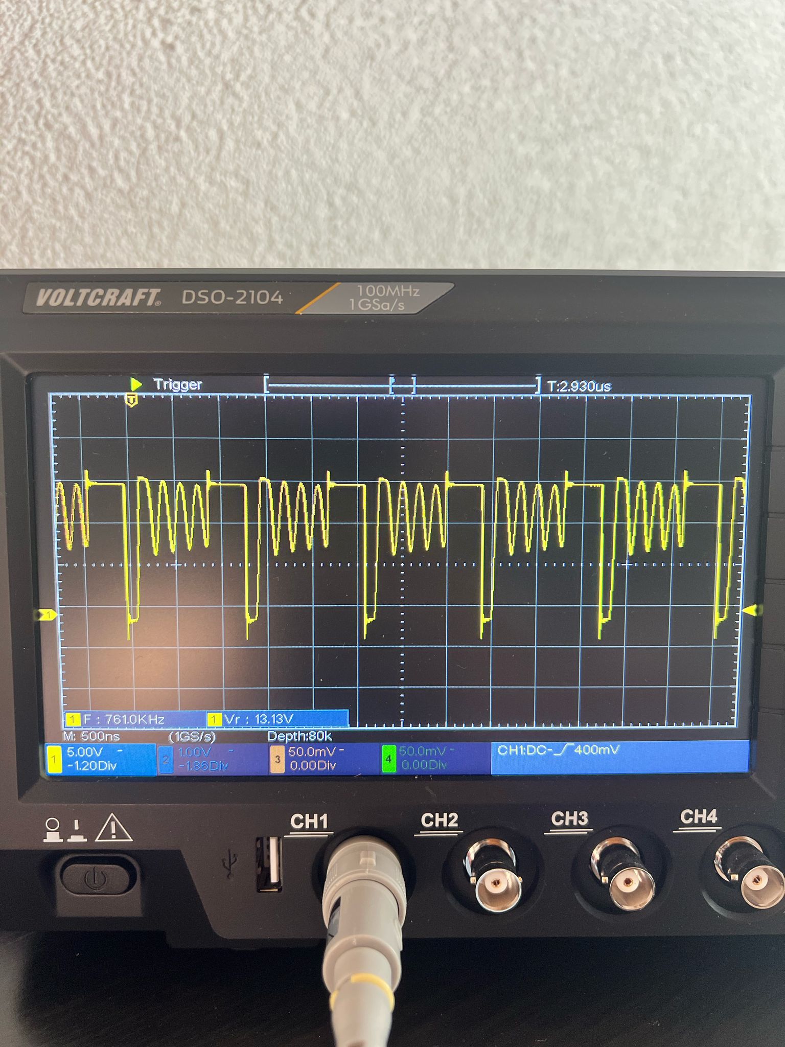

    When VBUS is applied, the 5V REGN comes up without a Problem. Here Are some OSZI Shots from the SW1 Pin. Something isn't right it seems with a Frequency of about only 60kHz. Do you have an idea why?
  • HI Bastian,
    If PFM is enabled and the load is light, the switching frequency is a function of load not fixed 750kHz in order to improve efficiency.  To prove that SDRV = BAT isn't the problem, can you disable PFM (REG0x12[4]) and/or apply a load at 1A or higher on SYS.  If the converter can supply that load but can't charge at that current, then the BATFET CSA is measuring incorrectly.

    I now changed the PFM Bit, it didnt Change the Charging Current Problem, but on the Oscilloscope I was measuring the 750kHz on The SW1 Pin. But what seemed strange to me is, that on the SW2 Pin a Constant Voltage of 12V was present, seemed to be VBat. What do you mean with BATFET CSA measurement? and what can i do about it? I thank you very much for helping me with this problem

    I was able to cut the connection between SDRV and BAT and connect the 1000 pF capacitor to GND. It works perfectly — the charge current immediately regulates to 1 A without any I2C communication, just as it should.
    Thank you very much for your support!
