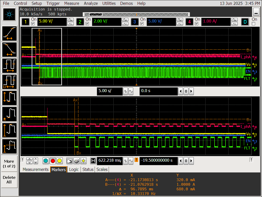

  • Hi Arush,
    How much load was applied?
    I tested 1.5A and 2.5A load at 1A limit condition with EVM. Same situation with 1.1A, 1.5A, 2.5A.
    As you see below waveforms, this limited ~320mA and retry after ~96ms.

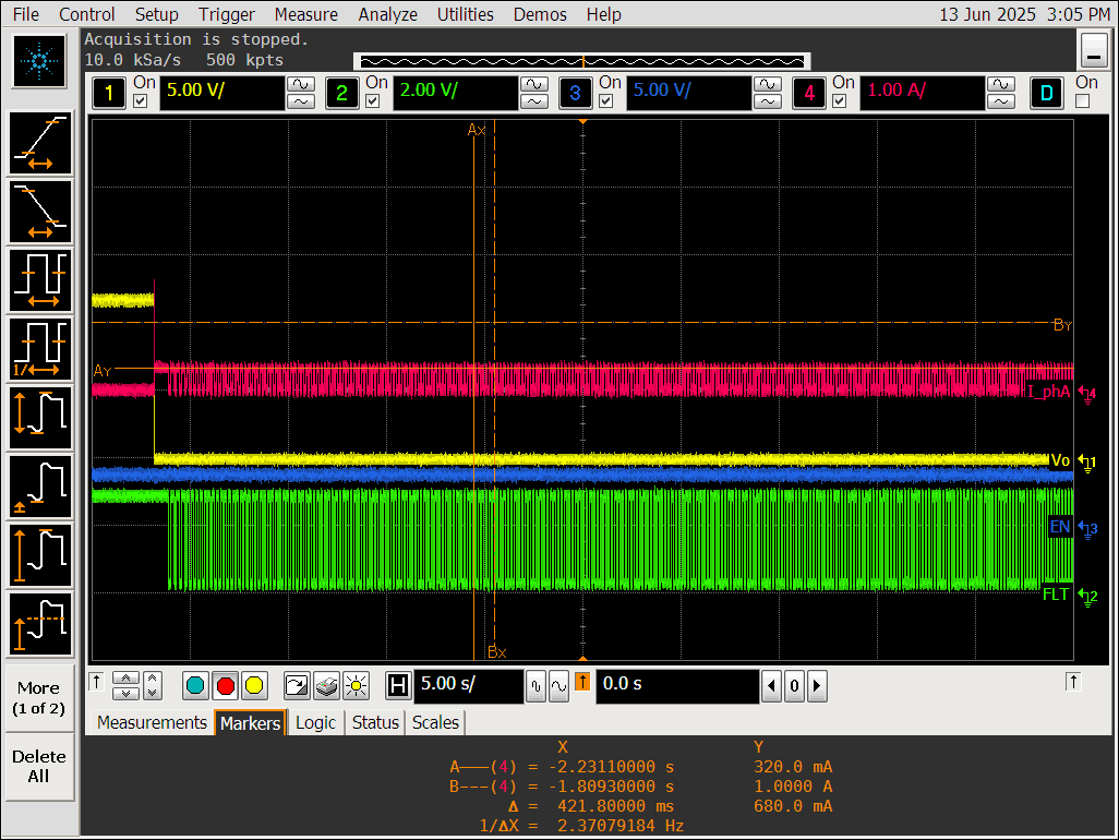

  • Hi Arush,
    We should not see this much current foldback for this device.
    When I saw the output current waveform, it is not 1A which I set up the currents limit, but it is 320~350mA.
    I've seen current limit foldback graph in the datasheet for 125mA and 2A I_limit. (Figure 22, Figure 23).
    www.ti.com/lit/gpn/tps2596
    For 2A I_limit and 12V at 20C, its foldback current is around 770mA.
    So I assume if I_limit become 1A, it is around 330mA and this is similar result of mine.
    So I thought the retry currents of 320mA on above waveform is foldback current.
    My thinking is wrong?
  • The waveform above, Vo (Yellow) is stay 0V even 320mA output current exist.
    Can we explain this? otherwise is it due to the set up? (E-Load CC mode)
    Ernest
  • Hi Ernest,
    This is indeed strange. I thought you applied output short in the waveform hence you are not seeing the Vout.
    Can you reverify if there is no output short. Also, can you use CR mode instead of CC mode.
    Arush
