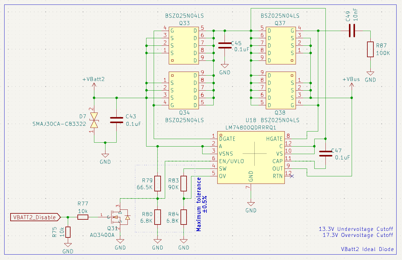

Hi, we are using two LM7480 ideal diode controllers to connect two batteries in parallel to a system. I have attached a schematic of 1 input below, it is the same for the other battery.
The behaviour we expect is the following:
  • If a battery voltage is higher than the other, all current should be drawn from that battery
  • If both batteries have the same (within some tolerance) voltage, current should be drawn from both equally
  • If a battery is below the UVLO threshold, it should stay off

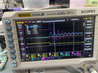

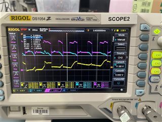

  4. Oscillations of the MOSFET when using a current limited supply with a load connected.
    1. On startup, the ideal diode oscillates between on and off due to the UVLO. This causes the MOSFET to heat up and emit an audible whine.
    2. Ideally the soft start should avoid this but it doesn't work.
    3. The attached oscilloscope pictures show startup
      1. Purple is DGate
      2. Blue is VBatt
      3. Yellow is Vbus (output)
Lastly, do you have any more information on MOSFET selection?
  1. Is there a minimum Rds(on)?
  2. Is there a maximum gate charge that is appropriate?
  3. Is there a specific range of appropriate gate thresholds?
  4. We are using 2x BSZ025N04LS in parallel, this means the Rds(on) can be as low as 1mOhm.
