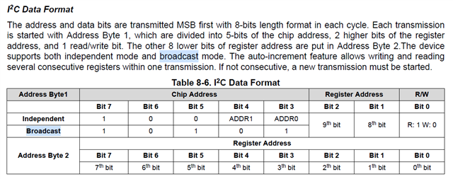

Hi teams:
The problem now is that there are two ways to define the slave address of LP5864: independent and broadcast. However, there is now a problem where I suspect that the slave address of my other I2C peripheral device happens to be the same as the broadcast address of LP5864, causing a conflict. (This means that I originally wanted to read and write to another I2C device, but mistakenly sent data to the broadcast address of LP5864). I wonder if there is any way to turn off the broadcast part of LP5864? I control LP5864, just use the independent defined slave device address
Best Regards!
