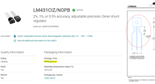

Dear support,
Customer is looking for
Series : LM431 series
Package : T0-92(LP) | 3
Lead : Formed lead
Packaging : Tape and Reel
I checked for TO-92 package, valid part no# are below but for LM431C, can I know which is the correct part no# is for LM431C formed lead (Kink) type?
LM431ACZ/LFT3
LM431ACZ/LFT4
LM431ACZ/NOPB
LM431AIZ/LFT1
LM431AIZ/NOPB
LM431BCZ/NOPB
LM431CCZ/NOPB
LM431CIZ/J7002806
LM431CIZ/NOPB
KPK
  • Hi KPK,
    Thanks for your question!
    Of the current orderable devices, none of them have the formed lead options.
    Please see some more convention information below:
    NOPB = Straight lead bulk pack
    If tape & reel = Formed lead only
    M = Magazine pack, formed lead
    LFT = National body dimensions (slightly larger) + eutectic die attach
    I hope this helps!
    Andrew Li
  • hi Andrew,
    Does that means i can only find: LM431AIZ/LFT1, LM431ACZ/LFT3 or LM431ACZ/LFT4 in formed lead package?
    LM431C do not have formed lead option, is that correct?
    Felix
  • Hi Felix,
    That is correct. Since the LM431AIZ/LFT1, LM431ACZ/LFT3 and LM431ACZ/LFT4 are in tape & reel, they are formed lead package. Please keep in mind the LFT signals the National body dimensions.
    Any ordering option with tape & reel comes with formed lead only, and orderable part numbers ending in /NOPB (may come in bulk pack, tube, etc) will have straight leads.
    Unfortunately, LM431C does not have formed lead option available.
    Andrew Li
