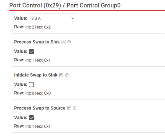

Hi TI,
I'm working with a custom board with a TPS25751 and I have a problem to setup the device correctly. When I connect my custom board with a notebook via the type-c port of the notebook the tps25751 fails to contract a power role, but I want that the TPS becomes sink and the notebook becomes the source.
My scenarios are the following:
  • Connect my board with a smartphone, the tps is the source and the smartphone is the sink
  • Connect to laptop with usb-a cable,  the tps is the sink and the notebook is the source
  • Connect to laptop with usb-c cable,  the tps is the sink and the notebook is the source
The first two scenrios are working, but the last case doesn't work.
Can I send a 4cc command to adjust this case or I can configure the TPS to work properly in all the cases?
I attached a link to download my configuration.
Thank you in advance!
drive.google.com/.../view
