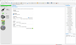

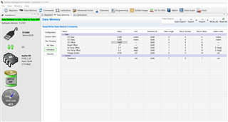

  • Hi Diego,
    Thanks for your reply. So for now the highest priority is to correct the current offset. I am very frustrated because it makes all processes inaccurate. Could you please check the setting for me to correct the offset? Here is my process to have current offset issue:
    1. I disconnected all the chargers and load, and there should be 0 current, However, it shows as an attached figure, 471mA, I also measured the actual current by current meter, it should be a few milliamperes almost 0A.
    2. I calibrated CC offset, succeeded; Then calibrated Board Offset; succeeded; However, 471mA offset current always shows there...
    3. I connected the electronics load and discharged at 2A, then calibrated at -2000 mA, and succeeded; The CC Gain and CC delta updated to 0.486 mohm, which is good because my shunt resistance is 0.5mohm. I showed my screenshot here. CC offset = -1429; Board OFFSET = -17
    4. I disconnected the load and charger again. 471mA offset current always shows there. According to your suggestions, I tried to manually update the CC Gain to make the current closed to 0. When CC Gain is 4.5, the measured current is 52mA, which looks acceptable. I calibrated the CC offset and board offset again, looks like nothing changed. However, when I connected the electronics load and discharged at 2A, the measured current showed -200mA, which is obviously wrong. After I calibrated the current at -2000mA, the CC Gain becomes 0.486 again.
    5 during all the above processes, CC offset's value is around -1430 and Board offset's value is -17 all the time, looks never changed. so I suspect if the cc offset and board offset don't work? How to fix it?
    6. I calibrated the current at 10A discharging, I compared the actual current and measured the current from BQSTUDIO. you can see that the offset will be reduced until the current is -10A, then increase. Do you think what's reason cause it? I attached the comparative table and screenshot, I am not sure if you can see them, the table and screenshot have the same content.

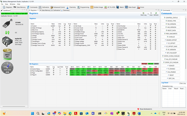

  • Hi Diego,
    I set the design energy is 16000 cWh (50Ah x 3.2V), however, the available energy is still the default max 32767 cWh. Do you know why? I have completed the learning cycle, and the SoC reading, FCC are correct. The available energy register reading is incorrect. I posted it in this thread. BQ34Z100-R2: Available energy reading issue after a complete learning cycle - Power management forum - Power management - TI E2E support forums Could you help me with that?
    Thank you
    Jiaqi
  • Hi Jiaqi,
    Are you using a constant power model or a constant current model? (Load mode Load select)
    A log file of the error would be helpful as well.
    Regards.
    Diego
  • Hi Diego,
    The load select is 1, Load mode is 0. Here is the log file. The SoC, Voltage, current, and capacity are correct, but the available energy is wrong. 2604.cycle.csv
    Thank you
    Jiaqi
  • Hi Jiaqi,
    If you are concerned with available energy, please switch to a constant power model. Please also review all parameters in W/Wh/mWh/etc in your configuration and verify that they are correct. Please share a new log and .gg file once these changes have been made.
    Diego
  • Hi Diego,
    My problem has been solved. I should set the energy scale.
