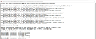

When I try to run the TPS7B8601QDDARQ1 integrated circuit model in LTspice, I receive an error. The error message and SPICE model are shown below. I would like to ask for your support regarding this matter.
Hi Mucahit,
Unfortunately, we are unable to directly support LTSpice as a simulator as we are unable to validate out models in it due to licensing terms. That said, the model does behave as expected in a couple of other non-PSpice simulators, so I suspect the issue doesn't lie within the model architecture.
It's possible that this error is due to nested curly braces on the affected lines. My suggestion would be to edit the lines LTSpice is showing errors on to consolidate the braces into a single opening and closing curly brace.
