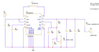

I am trying to driver a laser diode using the TPS63060. I have a variable power source from 3-6VDC (Vin). The laser diode has a Vforward of 2.5V.  During power up the circuit goes out of regulation, yet when I put a resistive load everything works fine. Is there something during power up that dos not like a diode load?
