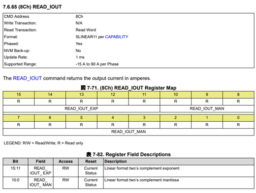

TPS546D24A: Measured current by READ_IOUT command(8Ch)
Part Number: TPS546D24A
Hi team,

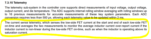

My customer has been designing the circuit with TPS546D24A, and has a question regarding PMBus function. My customer would like to measure the output current of TPS546D24A to measure the power consumption of the subsequent circuit by using READ_IOUT command(8Ch) on PMBus function. The inductor current is a sawtooth waveform, so my customer doesn't know the output value of this command is average current, peak current or valley current. Or other current? Please kindly let me know.
