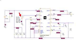

There is a description about level shift in snva856b.pdf.
But on/off control is working on PSPICE without EN level shift circuit.
Is it OK doing without EN level shifting?

Some of our PSPICE models might have internal ground. In PSPICE, it is possible that enable comparator's ground might be internally given as ground. That is why it might be working here.
In IBB, device GND is -VOUT. EN will be referenced to -VOUT and you would need a level shifter in actual application.
So, its not OK doing without EN level shifter
