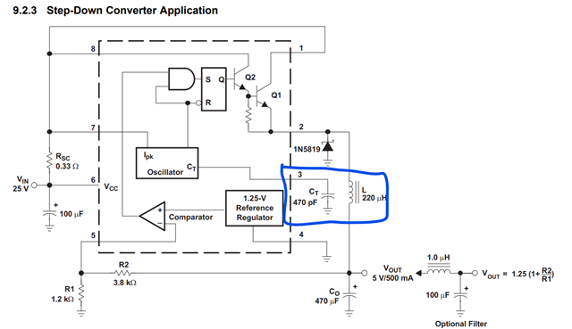

I'm trying to match the Buck converter design values through the Calculator from formula given in Datasheet.
From this calculation I'm trying to find the Frequency behind this CT & L. Considering this reference frequency value, I need verify other design we are using.
The calculator I prepared having issue such that, If I match CT, L is not matching and wise versa. Attaching the Calculator excel file and picture of reference design from Datasheet. Anyone please help to fix the conflict.

    Please be aware that this device is not a fixed frequency converter. The frequency changes with the current through the inductor. Especially if the current limit is reached.
    I updated the calculator according the formulas in the datasheet: MC33063A Step down updated.xlsx
    The formula for the timing capacitor needs 40 instead of 0.4.
    Brigitte

    Thanks for the updated file. I have gone through the formula, and it looks fine now.
    Yes, I'm aware that the frequency will change based on the current through the Inductor and Frequency can be controlled by Ct in this IC.
