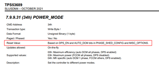

  • Hello Sawada-san,
    You are correct, the register POWER_MODE is reset by the DPS_EN bits, so it makes sense that the register would be reset until you enabled DPS:
    Glad that the settings are now changed.

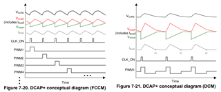

    Given that there is only a single phase operating, you should be able to see DCM when delivering low load. Probe PWM, CSP, and Vout. When regulating low-load, PWM should sometimes rise to 1.5V to show that the controller is operating in DCM.

  • Hello Nick,
    I checked the PWM, and it seems to be outputting only 3.3V pulses.
    If I switch from "Maximum Power" to "Maximum Efficiency" again while the device is powered on, I can observe a 1.5V rising edge.
    However, after performing a power cycle, it appears to revert to outputting only 3.3V pulses.
