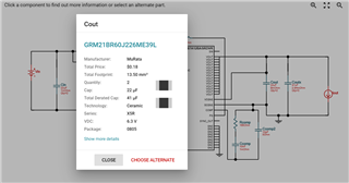

Hi when simulating the TPSM8287A12BASRDVR in webench it always selects 0805 22uF 2X for output caps, when I try to change it to the same as the input 22uF 0603 GRM188R60J226MEA0D it is not available in the database. Is there a specific reason this component is not an option for this design? the ESR is higher for the 0805 parts VS the 0603 parts.

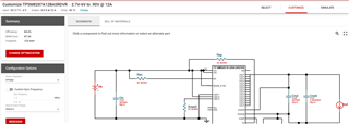

    When I create the default TPSM8287A12BAS design, for example, I get this.  The input caps are GRM21BR61A226ME44L.
    Webench uses an algorithm, based on its database of components, to pick each component based on cost, availability, size, and power loss.  You are still able to pick a different passive component.
    One guess at why that 0603 doesn't show up for a possible Cin (it's not clear if you're talking about Cin or Cout) is that it is only rated to 6.3Vin.  The default Webench design requires the Cin to have 10% margin to the IC's 6V rated Vin: 6.6V.  You can change these design criteria by clicking 'edit' in the BOM tab.

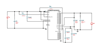

    There are two of the 22uF and three of the 47uF on the output.  The tool selects for the input  the 0603 22uF X5R 6.3V but picks the larger 0805 6.3V X5R for the output. That is what I am trying to understand/rationalize. We prefer min board area and that made no sense to me especially given that it has already selected the smaller same voltage same x5R for the input.

    I think I understand now.  The default design at those conditions gives:
    Cin: 2x 10uF, 0603
    Cout: 2x 22uF, 0805
    Coutx: 3x 47uF, 0805
    Each of these component selections requires different amounts of effective capacitance.  Cin requires 5uF per cap, while Cout requires 20uF per cap.  Coutx requires 3 times as much capacitance as is used for Cout.  So, that is where the values come from.
    Webench assumes that the load (and its Coutx) is placed 'not near' Cout.  Therefore, it requires (with some margin) meeting this requirement that the Coutx be twice as large as Cout.
    If you design your PCB, such that the load's input caps are right next to the output caps of the power module, then you don't need to meet the 2x requirement.
    To get smaller Couts or Coutxs to show up, you need to edit the required minimum Cout in the BOM and then pick new caps:
