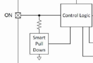

Is it acceptable to have the "ON" pin powered at 3V while the rest of the part (VIN and VBIAS) is not powered?  If it is acceptable, will the internal pull-down be in place in an unpowered state?

  • I don't think my question was understood.  What I am asking is if the part is not powered but the input pin ON, has a voltage level present of 3V from a back-up battery, will this cause any latch-up conditions, current path through the part, or any other undesired behavior in the part or is it tolerant to this pin being powered when the part is not powered?  The second part of the question was about the "Smart Pull Down" resistor on this input and if it would be in place in this unpowered condition.

    This device has smart pull down resistor at ON pin which will pull down the ON pin to avoid floating.

  • Thank you for the response but my question still was not addressed.  Will the smart pull-down resistor be in place when power is not applied?  In the situation I described power will not be applied to the part and the only signal that will see a voltage level above ground reference will be the ON pin.  In this situation, will the smart pull down be connected to the ON pin resulting in a current path to ground through the smart resistor or will it be seen as a high impedance path.

    1. Device needs VBIAS for charge pump and control logic to work. With out VBIAS smart pull-down may not effectively work. ON pin will be in floating state when no voltage at VIN and VBIAS.

  • Amrit - What I prefer is the smart pull-down to have no effect on the applied voltage to the ON pin when power is not applied to VIN or VBIAS.  You mentioned that without VIN and VBIAS that the smart pull-down may not effectively work, is there a way to definitively confirm that the smart pull-down will not affect the current path on this input - that is, will it truly be floating so no current flows through this pin?

  • Hello Chris,
    Sorry for the delay.
    Smart pull-down will not be engaged when VIN and VBIAS not present.
    It will not turn ON when it sees voltage across ON pin.
    We have simulated it without VIN and VBIAS and VON 3V. Smart pull-down not turning ON and current through ON pin is only the leakage current which is 0.1 uA.
