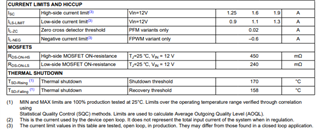

I am Pierre Tchamabe, Design Engineer at Murata Power Solutions. We would like to use your Buck Converter, LMR50410XFDBVR in our design and want to know its maximum short-circuit current limit across the temperature.
