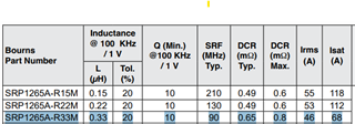

    I will try to measure the current across the inductor to make sure it is not saturating. The current inductor has a saturation of 68 amps, and my load should pull no more than 20A (18W at 1.2V). I will send the test results soon.
  • Hi Hugo,
    That sounds good. Please let me know what you discover. Given the inductor's saturation rating of 68A, it is unlikely that the inductor is saturating. However, examining the inductor waveform will help us determine whether the reading from READ_IOUT is incorrect or if it reflects the actual current.

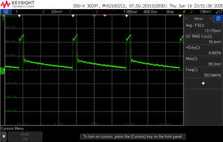

  • Hi Tomoya,
    This is the measurement I could get from the oscilloscope with a shunt after the inductor. Sorry for the measurements in voltage; I had to take quick measurements and didn't have time to set up the units, but I will walk you through it.
    I currently have a shunt of 1 mOhms, so the oscilloscope shows a peak current of 59.2 mV, which translates to 59.2 A. Now, the behaviour of the current waveform does not look like what it should be for a buck converter.
  • Hi Hugo,
    I’m not entirely sure what’s going on here, and I agree that the waveform doesn't resemble the triangular shape we would expect. This might be due to a measurement issue, such as coupling from the SW node to the probe.
    If you have one, consider using a differential probe. Alternatively, you can use two probes across the 1 mΩ resistor and apply the math function on the oscilloscope to achieve a differential measurement.

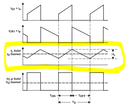

    I ordered different inductors to test them out. I have been reviewing several posts and datasheets for the TPS546D24A, and I haven't found a single paper that shows the expected current waveform for this device. Do you have any images of current sensing (waveform) in this chip done by TI?
  • Hi Hugo,
    The TPS546D24A is a buck converter. In steady-state, the inductor current looks like a triangular wave with a DC offset. Since the device doesn’t have a skip-mode or PFM mode for light loads and operates synchronously, it will work in continuous conduction mode even at light loads.
