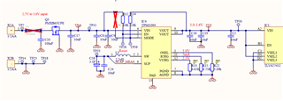

This is the power path for an iot device and while testing with multiple prototypes and batteries we have the problem that 70% of the time inserting my lithium LS14250 battery in the product the supercap is not being charged.
The idea behind this setup for EN and MODE is that on battery insertion the device is enabled and once Vout becomes high it goes to auto-buck/boost mode. The reason R14 is tied to Vout and not Vin is that with the battery removed Vin could drop to Vout -> device to bypass without reverse current flow, and then Vin could drop further and then the device gets disabled. Resulting in a user experience that removing the battery resets the device, instead of having to wait for possible a week for depleting the super-cap. I am still testing this.
In normal operation, both EN and MODE should be high and with a fresh battery the supercap should be charging. This is however not the case. Lithium thionyl can be a bit lazy if they have been on stock. That is probably why with my bench supply at 3,6V i have seen this occur only once, thinking it was a manufacturing defect and continued testing the other prototype. If you wait for a few hours the supercap usually ends up at around 0,3V while not charging. Waiting 24h does not increase further. Pulling EN low (with a button to gnd on TP28) usually fixed the problem. sometimes you needed to press it multiple times. Once it started charging everything worked as expected.
I tried to reproduce the problem and I can do that when a 10k series resistor is inserted series with the PSU. This is too big of a series resistor to sustain the current of the product (30mA peak, 6uA sleep) and the charge current of the supercap. Once i short the 10k resistor, Vout rises to Vin, but the supercap does not start charging, even while i expect it to do so. After a lot of testing i found out toggling MODE low, forces the chip to charge and even after releasing the button, it continues charging as it should. Of course the internal resistance of the battery is much lower, but this worked for reproducing the problem.
I have the feeling the chip latches in some weird state and misses the trigger it can start charging the supercap if the input voltage is sufficiently high. If i slowly turn on the input voltage charging starts when above the 3,0V setting of OSEL as expected.
For now i think the fix/patch is forcing MODE low with a transistor controlled by the microcontroller until the supercap is charged to about 0.85V (Vsup_uvl).

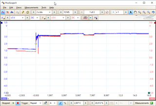

    For this verification, is the same one battery used? What's the voltage of the used battery?
    Is the battery inserted by hand? If so, I think there may be a big Vin ripples. If available, you may capture the voltage waveforms by a oscilloscope.
    Could you try a quick experiment as below:
    1. Set the EN = low and mode = high, to disable the device;
    2. Insert a fresh battery, make sure that the battery voltage is high than the Vout target (3V);
    3. Pull the EN high to make the device in auto buck or boost mode.
    Lei

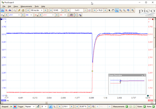

  • Hello Lei Zhong,
    Thanks for your quick reply.
    For testing i use the same battery continuously, but for production we use new ones, which could have been on stock for serval months.

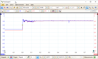

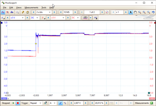

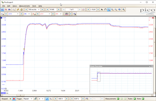

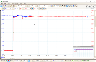

    Blue input at VIN (TP11) and VOUT (TP30).
    When i measure the battery before insertion with my multimeter it is 3.67V
    When inserting the scope measures the first peaks at 3.65V, but the deeper drops in the first 150ms are 2,7V. After 600ms it is 3.05V
    Supercap is around 0,5V.

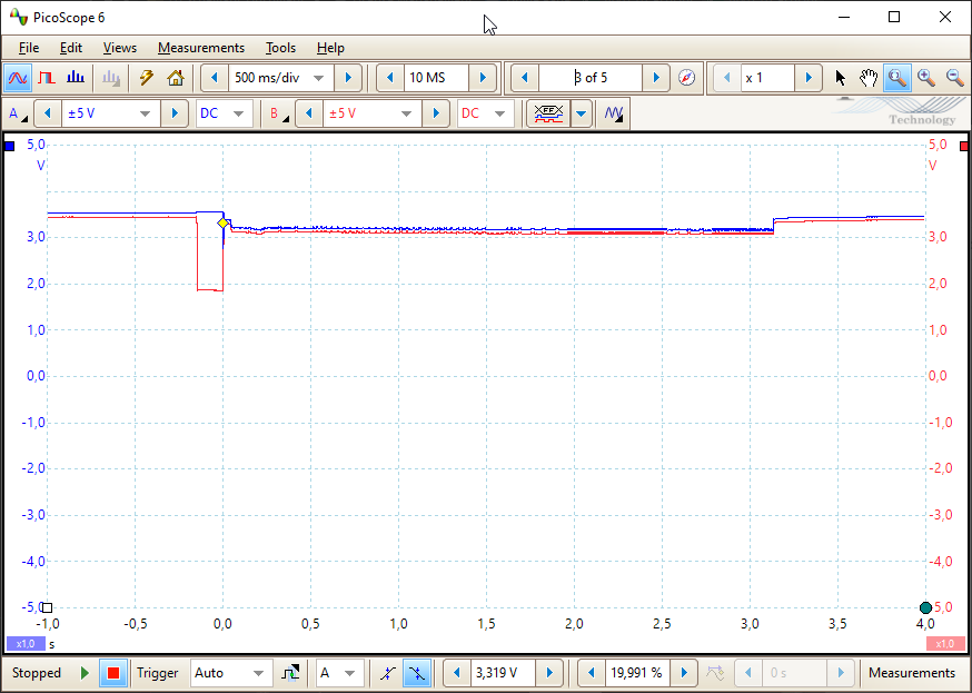

    In the above capture it started charging the supercap succesfully

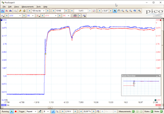

    In this one it did not

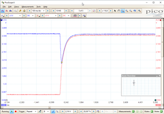

    This one was succesfull

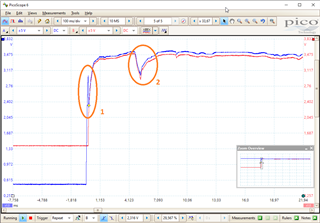

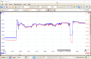

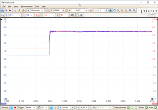

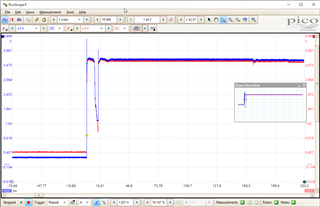

    Zoomed in on the battery insertion, wee see some nice contact bouncing. This is off course to be expected for a battery product i guess.
    Also interesting to see that the voltage drops quite significant in the beginning. These are all the processors booting. Current consumption here is probably a bit higher. I might be able to do some software optimization here too, i could probably shave off 3 seconds, not sure.

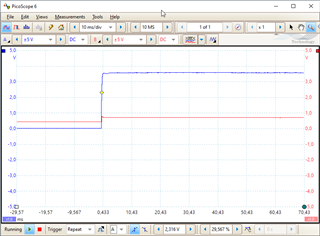

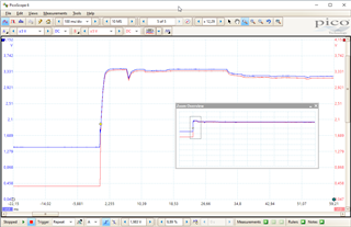

    None the less i expect the chip to go to buck mode once the voltage has rissen sufficiently. At 4 seconds it is 3,35V

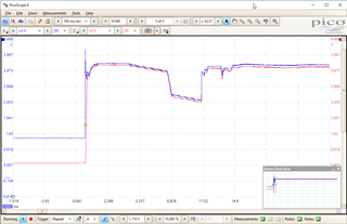

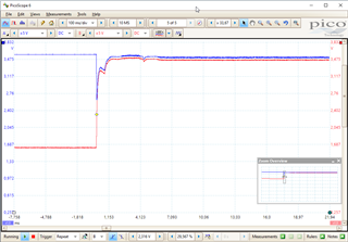

    This one also not succesfull.

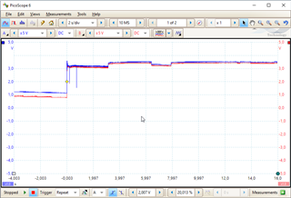

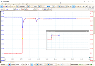

    Here i press the enable button to pull enable down. The device goes to true shutdown mode, and you see the output drop instantly to 1,8V, the voltage of the next converter and subsystem. This time pushing the enable did not start the charging sequence. sometimes it does it instantly, sometimes you need to try 10 times.
    I also made a button to ground on the mode pin. Pressing this always fixed it instantly. This is probably a hint that the main problem is not only in insertion, but the bigger load on startup and floating around the 3V which is the OSEL setting.
    Nonetheless i expect it to go to supercap charging after those initial 3 seconds of bigger load.
    If there is more to test or measure Let me know.

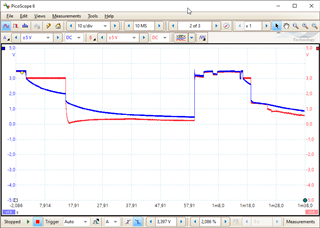

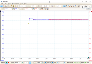

    Bonus measurement:
    Input and output, when i remove the battery. You see the input voltage slowly drop, in about 15 seconds to 1.8V (scope in 1/10 mode, but we don't know if it also drops if we don't attach the scope). It does not drop further so the tps61094 remains enabled and active in boost mode. Next event i press the mode button forcing the chip in buck mode, immediately dropping the output voltage. Next event i re-insert the battery. The supercap is not empty here so this helps in startup i guess, supercap is charging. This time i press the button really short but still enough to drop the output voltage to 1.4V, which should be sufficient to disable the system. It is a good thing that the input drops far beyond the output though, so probably i can measure and detect battery removal.
    So maybe controlling the mode pin with the MCU can also have an advantage here.

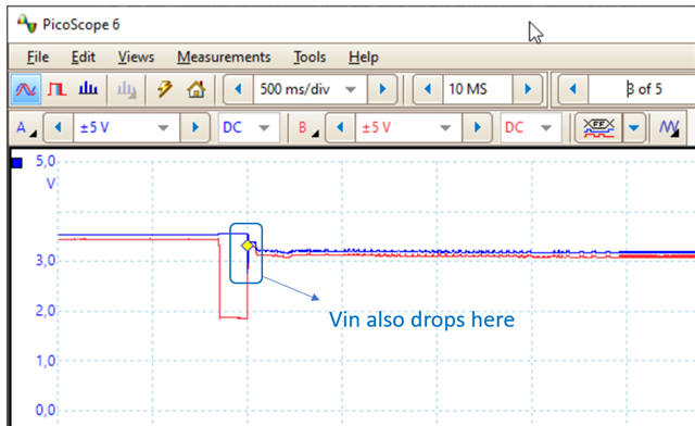

    I think the issue is related with the contact bouncing when the battery is inserted.
    In your application, is it possible to pull the EN down, insert the battery, waiting for the Vin voltage is stable, then pull the EN to high?
    Please note that when you try to pull the EN to high, will the TPS61094 load be very big when the Vout reaches the target? If so the instant input current is also big and make the voltage at the VIN pin drops.
    I'm asking because I watched Vin drops in the following picture you attached when EN goes to high.

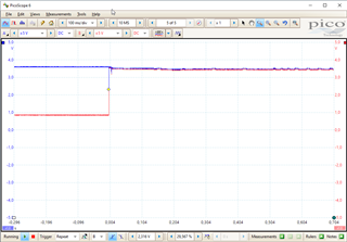

    Battery insertion with enable low. Some voltage gets to the output. That should not be possible to leak through my system, but i have to remove everything for that to be sure. Also it is is not an issue, there normally is no state with the TPS disabled.
    This did not increase the chance of it to get charging. (tried 20 times, 0 started to charge) (press on mode pin to pull it low, release it, and it starts and keeps charging, works every time). If i button bash it (press it multiple times in fast succession) i can get it to work with the enable, otherwise not. If the supercap is above 0.85V it keeps working, But i test with it <0,6V.
    Zoomed in on the enable event.
    The input voltage drops to about 2.5V. All the capacitors on the pcb add up
    I removed the wifi subsystem, which is connected to the 3V0 Net via a loadswitch (TCK108AG). I removed the load switch to make sure that even without the microcontroller powered the system does not contribute to the load.
    The measurement still looks the same. So the output capacitors of the TPS itself are the main contributors.

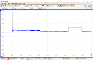

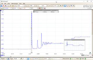

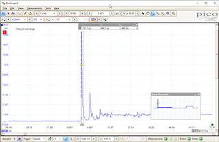

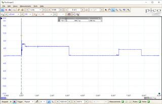

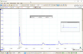

    Next i measured the startup current, without wifi. Measured with the EEVblog uCurrent set to 0,1mA/1mV measured through a 1R shunt. Scope connected to the output.
    not charging 4.7mA
    does charge 8.4mA
    (The current in these prototypes is debug firmware so low power is not correct). The first 3 seconds is around 20mA. then 8, and from 6,5 to 8s around 38mA.
    Current exceeds the 200mA scale and is about 100us wide.
    Without wifi it starts about 9 out of 10 times when inserting the battery. Big improvement, still unacceptable :).

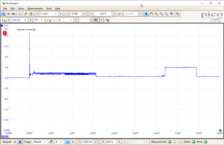

    Next i test with my prototype with wifi.
    Initial current block rises to 50mA, with the smaller bump before that of 65mA for 180ms.
    The inial peaks are also wider.
    Re-measured with different scale
    up to 510mA when inserting the battery. Which is surprising given we have 30uF on the input.
    Conclusion up till now: reducing power consumption improves the odds greatly, though it does not fix the problem. Holding the enable button when inserting the battery makes it worse with wifi subsystem, and better without. In both cases the load is nowhere near the limits of the TPS61094.

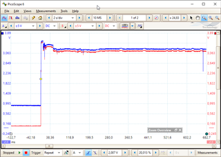

  • As a bonus i changed the battery to the lab supply. configured to 3.55V and to simulate the insertion, i insertion the banana plug.
    Some violent swinging, it started to charge however.
    I was going to say it works every time, but i got it to fail
    And another fail
    pressing enable fixed it.
    (tested the part with wifi)

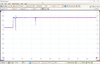

  • Hello Lei,
    I was a few days out of office but here we are again :)
    succes
    and fail on the 7th try.
    These look very similar, i can't tell why the 1st time has succes and the above fails. When compared to before the extra input capacitor you can see that the input voltage spike on insertion is nearly gone and 2 the voltage dip is a little less this time, but very little.
    inserting while enable is low and then releasing enable, we get the above measurement. It improved, so did the outcome of the test. First the input voltage dipped to about 2,2 - 2,5V now that is 2,75 - 3V. I tested about 30 times and every release of the enable resulted in a succesfull start of the supercap charging.
