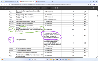

In datasheet is written that if you wanna change the rise/fall time of the MOSFETs you need to change the Rdsg or Rchg resistor:
Now i just want to make the fall time of charge and discharge FETs faster.
But as im thinking, dont i need to change the Rgs_dsg and Rgs_chg (the gate to source resistors) instead of Rdsg and Rchg?
I mean when the FETS are turned off, the charge in the gates is flow vie the Rgs_dsg or Rgs_chg to the source? or is that wrong.
Which resistors do i need to change to make the fall time faster.
