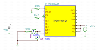

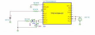

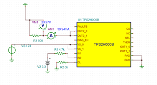

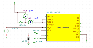

Hi Team
In simulations, both TPS1H100-Q1 and TPS2H000-Q1 ICs are showing expected output currents of 5 mA and 40 mA. However, during practical testing, the TPS1H100-Q1 does not achieve the 5 mA of output current.
can I expect the TPS2H000-Q1 to achieve the expected output current in practical testing?
For , Suppose both ICs are not possible means, please suggest a alternative part number.
These simulations are done in TINA
The simulation results are
