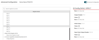

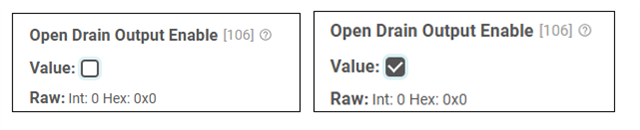

Hi teams:

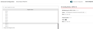

this is what I did to modify IO Config register (0x5c) in GUI advanced mode
but I found that the bit 106 remains same "RAW:Int:0 Hex:0x0" when I checked on the "Open Drain Output Enable" value.
shouldn't this bit [106] be "RAW:Int:1 Hex:0x1" when "Open Drain Output Enable" value is checked ?
Best Regards!
Iris
    Can you provide some details about the GUI version you are using and how you observe the raw values?  I do not see bit 106 as an option.
    Chris
    I can see now your reference is to GPIO10 and when the IRQ is not selected.
    Will test on our side to understand what is happening with the GPIO.
    Chris
    I can confirm that the Raw:Int 0: Hex 0 is correct and that this cannot be changed by selecting the Value [].  This applies to both GPIO10 and GPIO11.  Can you use a different GPIO?
    Chris

  • Hi Chris,
    I have tied this I2Ct_IRQ to 1V8 through a 10K resistor. However, I can see there is 3V3 output from this pin.
    Is there a way to configure it to operate at 1V8 ?
    Best Regards!
    Iris

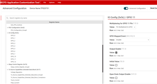

    By default there is an internal pullup enabled.
    You could attempt to clear this value in the GPIO10 view and then return the Multiplexing for GPIO10 to 'Pin Multiplexed to Alternate Function(I2Ct_IRQ), however, i do not know if that will work.  I will also test on my side, but this may be a limitation of the configuration tool.
    Chris
    I was able to confirm that the pullup can be disabled by first disabling in the GPIO10 perspective and then returning to the I2Ct_IRQ function/perspective.
    Chris

    1. I followed the steps you suggested but I still see 3V3 at I2Ct_IRQ.
    Thank you for testing on your side.  The EVM has a pullup to LDO_3V3, so i am only able to confirm that the binary changes when I perform the steps.
    Is it recommended to use the older version V1.0.2 GUI ?
    If you need to mee the latest specification, then use 1.1.0.

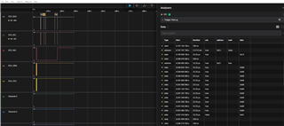

    After successfully downloading the patch, we directly read the value of the 0x14 register and found that Bit 0, 1, and 3 were all set to 1. There is a question that Bit3 of the 0x14 register is set to 1 when inserting or unplugging the USB, but we do not have any USB insertion or unplugging actions
    As part of the device flow the Ready for Patch interrupt will be set to indicate that the PD controller has completed boot and is ready for the patch.  So you should expect that the interrupt line will be pulled low.  Bit0 is reserved, so that is not expected.  Also, if only the Plug Insert Removal (bit3) is selected in register 0x16 then the other bits should not be set.
    After the patch download can you clear interrupts and confirm that the system is stable?  Is the download from an embedded controller or an EEPROM?
    Chris
    Please be advised that the I2C communication uses SMBUS protocol so the first byte is the number of bytes in the register.  Using the EVM i was able to capture the following during the patch load process on I2Cc.
    The 0x0B is the size of the register.  11bytes*8bits = 88bits => 0-87
    When i write to register 0x18 then the interrupt goes high (red, channel D2).
    Chris

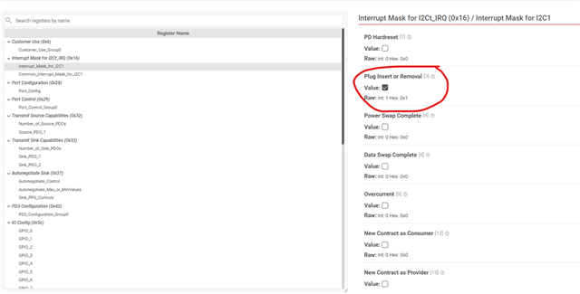

    If the EC is used to load the image to the PD controller via patch burst mode, then I would consider using the Command Complete interrupt (30).  Since this is used during PTCH this is not configured in the GUI but must be configured by the EC at run time.   Please find the attached example.
    /cfs-file/__key/communityserver-discussions-components-files/196/tps25751_5F00_MSPM0_5F00_PBM_5F00_01.c
    I would recommend using Command Complete (30) and the plug insert removal (3).  Upon insertion you can then query to the PD controller to determine the state and perform the GPPI/MBRd command to determine what the port partner is and that you are in the desired power role.  If not in the desired power role then a swap command can be issued (SWSk or SWSr).
    https://www.ti.com/lit/ug/slvucr8a/slvucr8a.pdf#page=59
    Chris

    After some troubleshooting, we are able to see the IRQ going high after clearing the 0x18 register. Thanks for your support.
    Could you advise which fields in the interrupt mask register (0x16) are recommended to monitor?
    Our product is a Bluetooth speaker, the PD is controlled by an embedded controller and operates in DRP mode
    (act as a sink when is connected to AC adaptor/ powerbank/ laptop, and act as a source when is connected to mobile phone).
    Bset Regards!
    Iris
  • Hi Chris,
    Thanks for your reply!
    We added it to the interruption event PD Hardreset(0)、Plug Insert or Removal(3)、Overcurrent(9)、New Contract as Provider(13)、liquid detection(60) What should we do to trigger PD Hardreset and New Contract as Provider interrupts among these five events, and do we need any other interrupt events?
    As well as your previous suggestion to add the CMD1 Complete (30) interrupt, what should we do and how to use the GPPI/MBRd command? Can you provide a reference code example

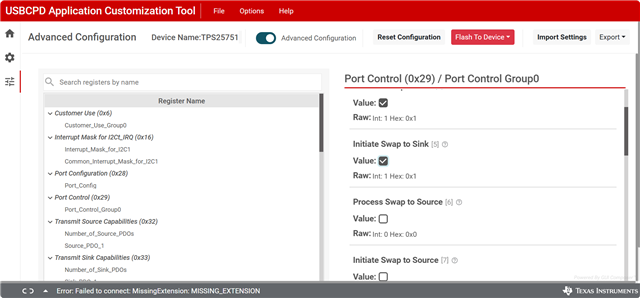

    I want to ask how to plug in the computer to power Speaker
  • Hi Li Lefty,
    If you want the computer to power the speaker, you will want the speaker to be the USB-C PD sink.
    Depending on your configuration, you may need to do a couple things.
    Check that you are acting as a source
    1. to initiate a swap to sink, you can use send the 4CC "SWSk" command to attempt to PR_SWAP to sink
    2. Make sure that the Port Control -> "Initiate swap to source" field is not set, otherwise the TPS25751 will automatically attempt to do a PR_Swap after you send the SWSk command.
    3. Make sure that the Port Control -. "Process swap to sink" field is set as well.
    Thanks and Regards,
    Chris

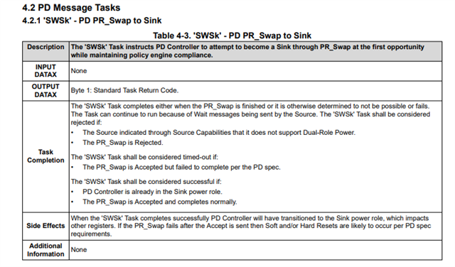

  • to initiate a swap to sink, you can use send the 4CC "SWSk" command to attempt to PR_SWAP to sink
    Hi Chris,
    May I ask under what circumstances to use the 4CC "SWSk" command? What judgment needs to be made before executing the 4CC "SWSk" command?
    The pictures are some of my configurations
    Best Regards!
    Iris
  • Hi Iris,
     From the TRM.
    You can technically use it at any time, but the PD controller may reject it if certain conditions are not met.
    1. Must be in a PD contract
    2. You should be a source, although the command should
    3. Process swap to sink must be set in "0x29 Port Control"
    4. The task can be rejected by the far-end, and sending this command even with the previous setting correct does not guarantee the power role swap will happen.
    Why do you have try.Src set? Do you prefer to be DFP/Source on initial connection? If you don't have a preference, you may want to set the support option to none supported.
    Thanks and Regards,
    Chris

        MSDK_LOG_INF("[PD] Partner is not host-like (likely mobile or accessory). Stay as Source.");
        return;
        MSDK_LOG_INF("[PD] Partner supports DRP. Attempting to swap to Sink...");
        /*Step 4: Use property set encapsulation to send 'SWSk' (Swap to Sink)*/
        msdk_usb_c_propval_t swap_val = { .custom.usb_pd_pr_swap = true };
        status = tps25751_property_set(dev, MSDK_USB_C_PROP_CUSTOM__USB_PD_PR_SWAP, &swap_val);
        if (status != MSDK_STATUS__OK) {
            MSDK_LOG_ERR("[PD] Failed to initiate power role swap (SWSk)");
            return;
        /*Step 5: Polling waiting becomes Sink*/
        uint32_t elapsed = 0;
        while (elapsed < PD_SWAP_TIMEOUT_MS) {
            msdk_usb_c_propval_t check_val = {0};
            if (tps25751_property_get(dev, MSDK_USB_C_PROP_SOURCE_SINK, &check_val) == MSDK_STATUS__OK) {
                if (!check_val.source_sink) {
                    MSDK_LOG_INF("[PD] Swap to Sink successful.");
                    return;
            msdk_time_delay_ms(POLL_INTERVAL_MS);
            elapsed += POLL_INTERVAL_MS;
        MSDK_LOG_DBG("[PD] Swap to Sink failed or timed out.");
    #endif // CONFIG_MSDK_DRV_TPS25751
    static bool is_host_like_partner(uint32_t raw_pdo)
        bool b29_dual_role_power = (raw_pdo & (1 << 29)) != 0;
        bool b26_usb_comm_capable = (raw_pdo & (1 << 26)) != 0;
        bool b25_dual_role_data = (raw_pdo & (1 << 25)) != 0;
        return b29_dual_role_power && (b26_usb_comm_capable || b25_dual_role_data);
    Best Regards!
    Iris
  • Hi Iris,
    This is somewhat expected. Initiate swap to sink will always attempt a power role swap when in the source role, and will complete if the far end supports the PR_swap.
    The PD controller does not have a good way of knowing what type of device is connected on the far-end, and bases the role swap only off of the current power role.
    You could potentially disable both "initiate swap to xxx" settings and let the far-end decide if it prefers one if setting initiate swap to sink. It is up to your MCU to determine when is a good time to stay as source or when to swap to sink. We can not provide too much guidance on when to swap power roles as it may be specific to your system.
    Thanks and Regards,
    Chris
