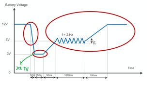

I'm planning to use LM74722-Q1 part as Ideal Diode Controller for a battery design where my designs should work in Cold Crank (3.2V), Normal condition (12V) & Load Dump (32V). As per the datasheet, the rising threshold for VA supply varies from 3.1V to 3.85V.

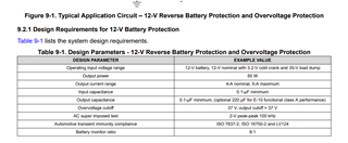

The datasheet shows that the typ value is 3.4V which is more than my cold crank level. But there is a application design where they considered 3.2V cold crank condition and performed the analysis but there is no sufficient test to justify the cold crank operation in the datasheet.
It would be helpful if someone can help me in figuring this out.
