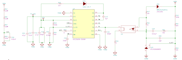

Hi, I am using TIDA-010081 reference design to drive 48V output with 20 Amps. I redesigned the LLC transformer. I am getting low voltage output of 31V and not getting the desired output of 48V. When using a small load , the power supply is not able to drive the output and fluctuating between 3 to 4 volts. I have used recommended parts by TI. LLC transformer is 4:1, using PQ3535, Primary : Secondary : BW 16:4:2, what could be the reason for low voltage at secondary.
